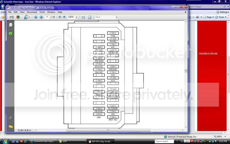

^Indeed, that is where the other fuse box is located. Here is the diagram for that fuse box for future reference:

so which on eis the fuse for the radio under the steering wheel?

i checked that one and that one is fine....is there another fuse for the radio unter the steering wheel?

It may be the accessory fuse (which is under the steering wheel), although I would think you would notice other lights off as well. Did you drive it at night or only during the day with your headlights off?

yes it was the ACC 7.5A fuse now my radio works again thank god, reason y it blew a couple of months ago i installed the F1 carbon fiber mirrors and i didnt like them and the guy that installed them cut my stock mirror plug and all the cables were touching on the passenger side mirror, so when i put the stocks back and went to adjust the mirror the radio blew, and then i checked the mirror and realized this d*ck head had all the cables touching....so it basically blew the fuse under the steering wheel column but everything seems fine now thanx alot every1
