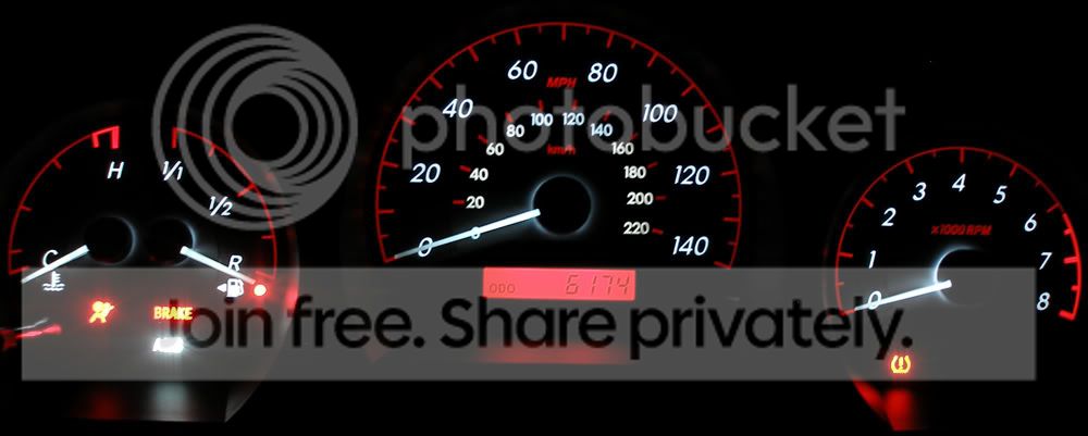

Do the numbers in white and the lines green. Mine are red and white like that and it looks effin sick!

Nope just switched the LED's. Those aren't mine but mine are the exact same way but my pics are blurry so whoever's pic that is don't flip out. I'll take another of mine when it gets dark and put mine up. The only difference is the mileage.

A guy in my club did it for me because I had no idea what the hell I was doing. The only thing that was kinda tricky was the film he has is red while there is no light behind it but when we shined a light through it it went pink so he had to double layer it. Plus he was having a little trouble cutting it for the lines on the Km part because the ticks are so close to some of the numbers.

when i did mine, it took about 5 hours because of trial and error soldering...first time soldering something small on a board, and some of my initial contact points from the LED to the board were bad so i had to redo those...but overall great result and mines Blue lines and white numbers/letters...like the pic above with the red and white, but blue and white i also did white needles and the odometer LCD filter flip trick to match.

What do you mean. Everything that is red is a red film cut to only be behind the lines.

All of the LED's that you don't want orange need to be changed to white and then trim some color film for wherever you want it a different color and voila! I also had some of my dummy lights changed to either white or red

the red ones look sick.... nice
