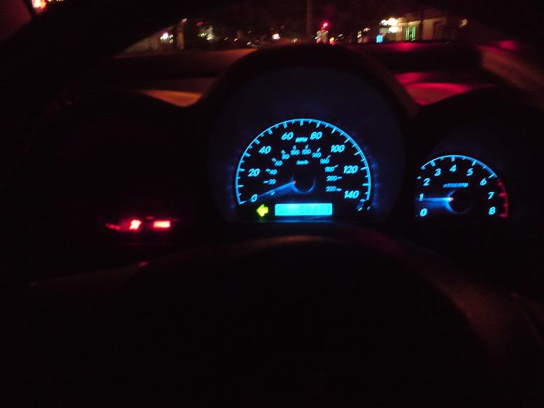

any ideas? i opened it and took a look at it but everything seems to be in tact... it went off, one morning it came back on and i drove for a good 5 mins and it went off again...

probably just a loose connection somewhere..

you should just reheat all your connections.

absolutely if one of the went cold. or looks not so shiny than its probably not conducting. or one of the led's may be burnt out.
but resolder the points if that doesnt work desolder and then reset them sometimes the solder doesnt flow unter the corners of the plcc2s properly making it difficult to transfer electricity.
