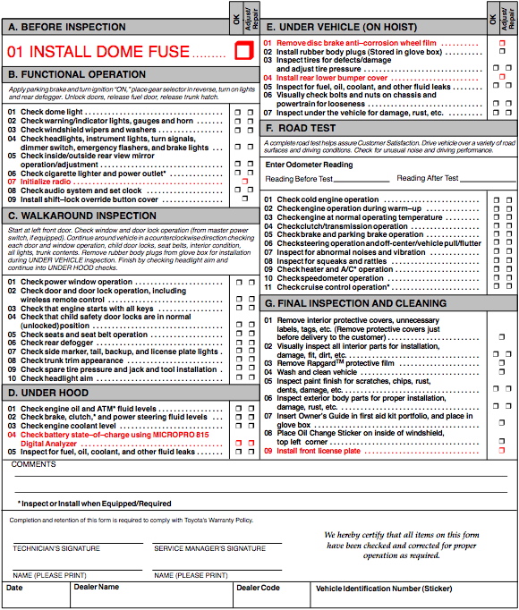

On the dealer pre-delivery test form of tests that they are REQUIRED to make on EACH car BEFORE delivery is a requirement that all door locks work both manually and via remote.
The requirements are set by Scion...
As a sample here's the PDI from for an xB Classic: http://tijil.org/scion_xb_pdi.jpg
