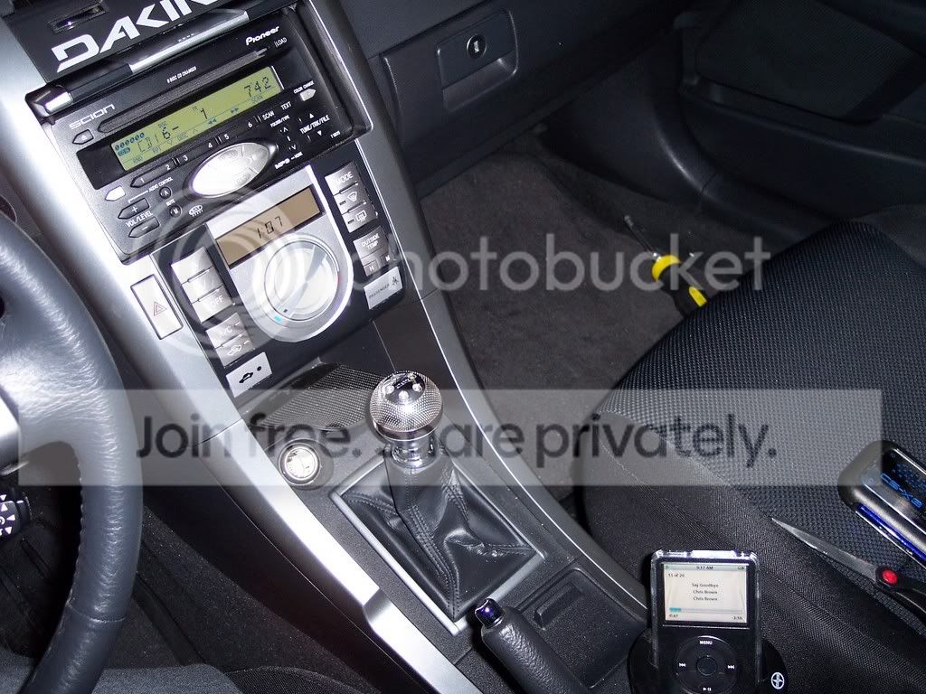

Yeap like stated i managed to get this DF-Toy aux input on my HU and it WORKS!!! Here are pics.

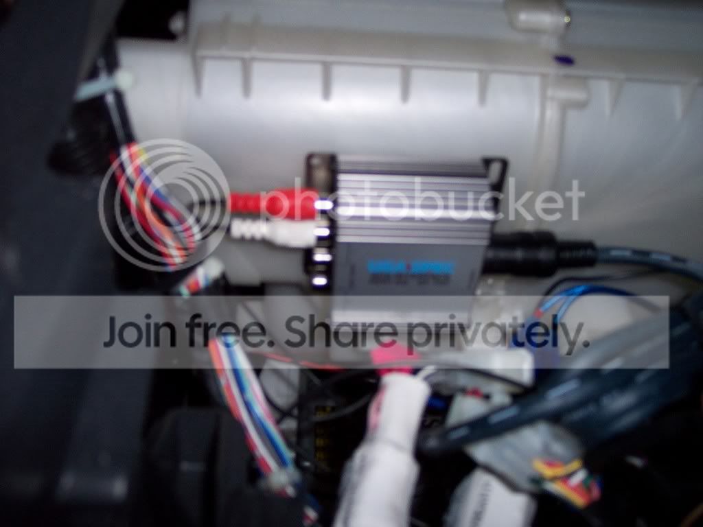

This is what the product looks like.

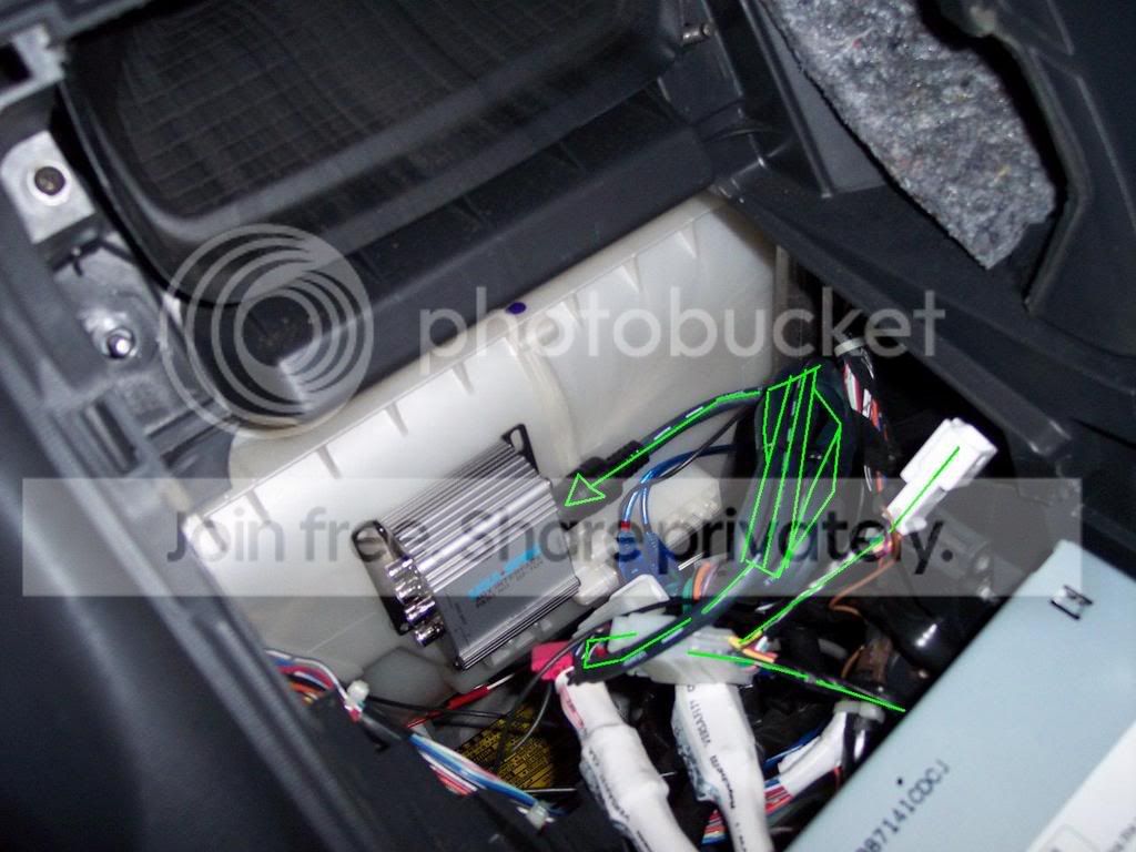

The green as highlighted is what the connection looks like.

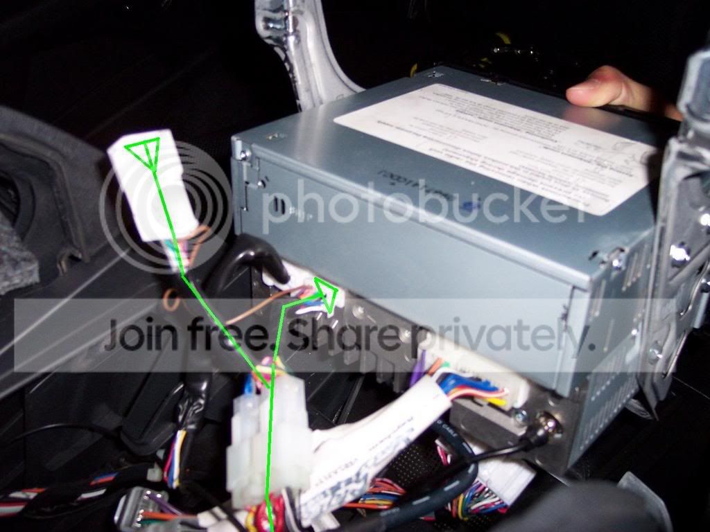

Connected to the back of the HU to the space clear of anything
With the AUX to the ipod. There are 2 aux inputs.

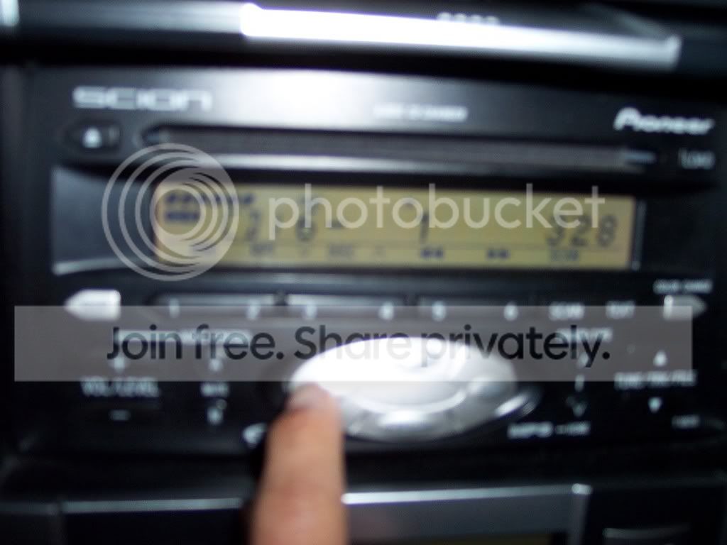

Sorry for blurryness but this is what 6 cd looks like on normal cd run
Press CD again and you hit "CD1" mode (aux 1). (If you hit CD again you hit "CD2" which is the 2nd aux on the interface)

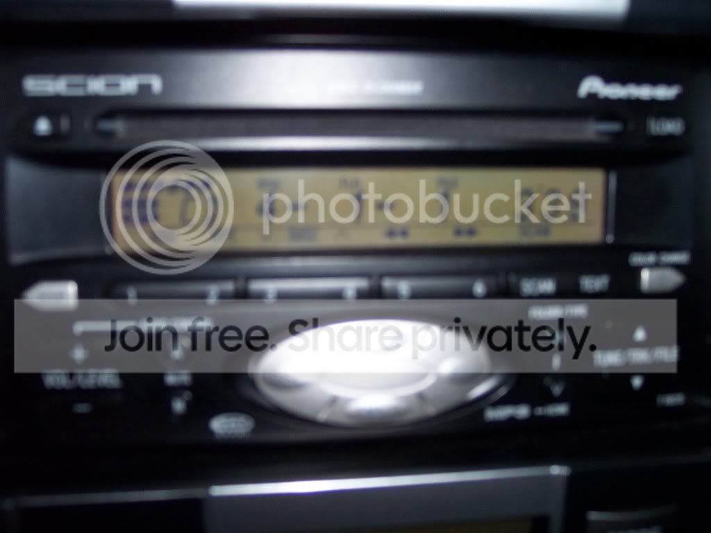

HU to Ipod

The end result...
GOODBYE FM TRANSMITTER!!!
