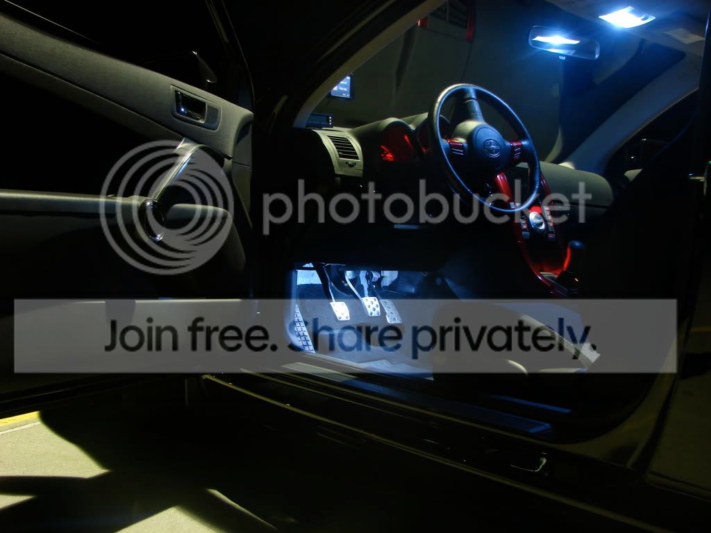

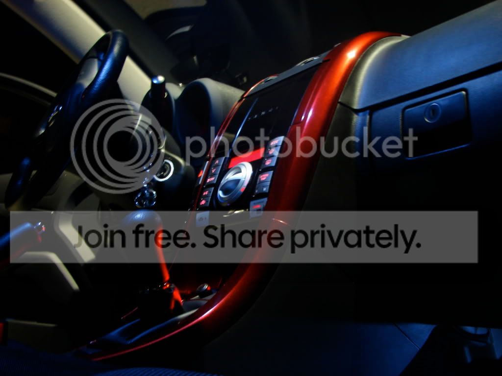

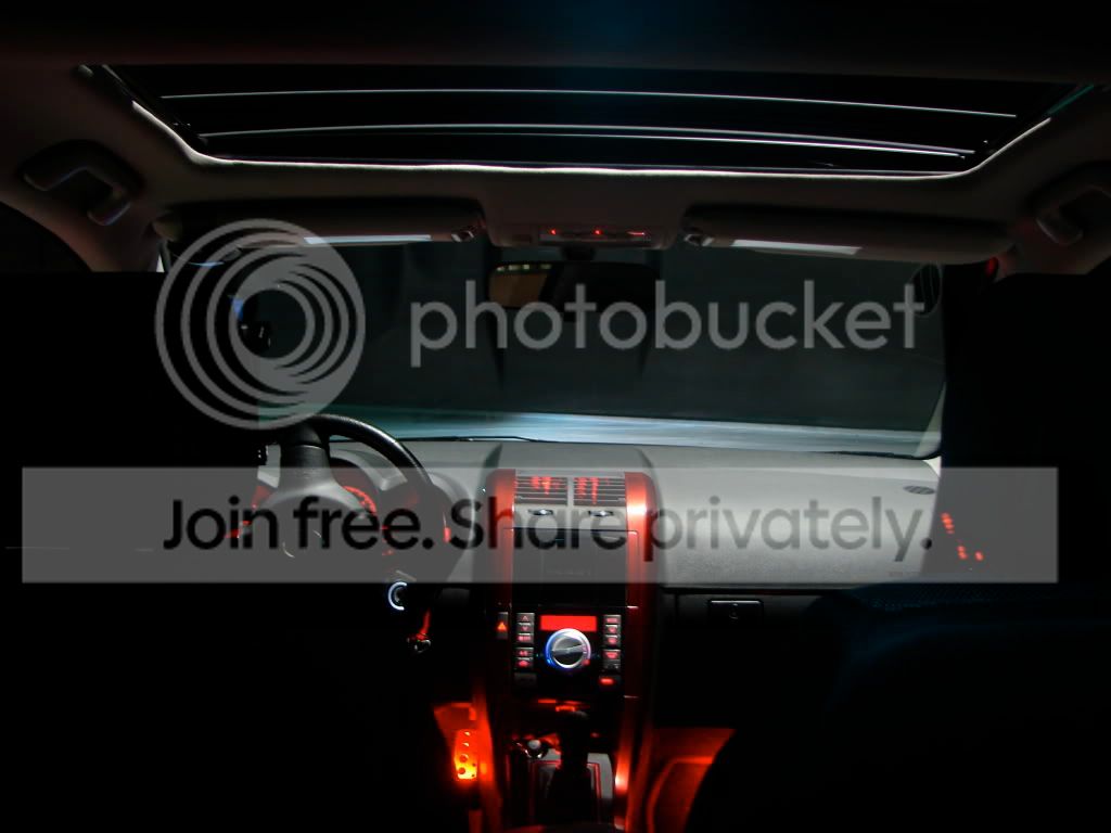

Well I don't think anyone on here knows what my interior looks like since I've done some work to it, so I thought I would go out on this pleasant Michigan evening and have a little shoot :-)
these are my interior mods so far: IS300 pedal swap, Doctor Isotope GearSwitcher (2" height reduction), red accent lighting, white accent lighting connected to the dome light circuit, red led swap, painted interior pieces (BSP door handles and waterfall center, Duplicolor Red Metal flakes waterfall sides and steering wheel trim)
enjoy:

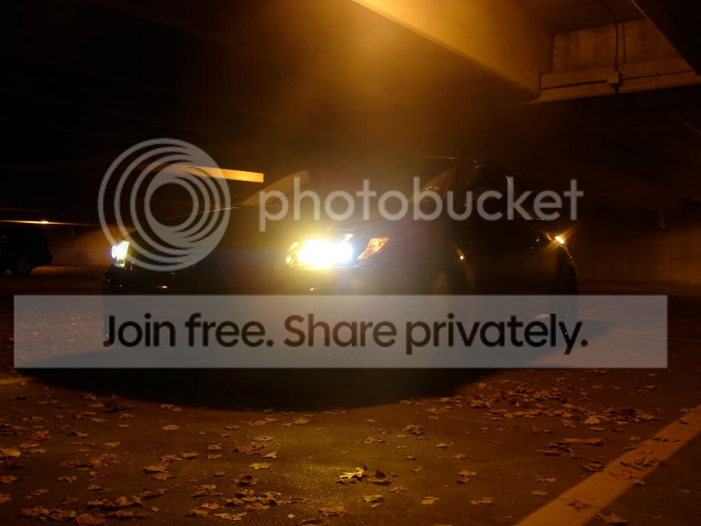

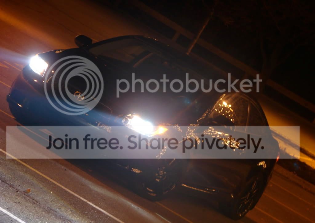

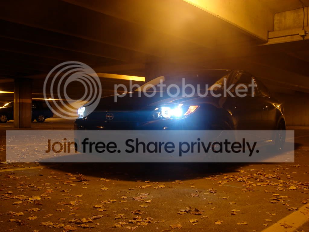

and as long as I'm posting pics...
wow I cant believe there are already Xmas lights up in places...
let me know what you all think

looks good man and the paint looks good as well, looks similiar like my interior with the red lights but i got BSP painted pieces if you get a double din then get it with the navi and get rid of the navi on the window, overall i like.

awesome paint scheme. nothings more pimp than red/black. love the shortshifter and pedals! where did u get the pedals?

looking good man, i cant believe those are 5000k hid's they are sooo blue!

did u change the color of the gauges or it was stock like that

thanks for the compliments guys
I got the accelerator pedal off eBay, and i think i got the brake and clutch pedals online from some toyota parts dealer. The break and clutch pedals are a direct fit but the accelerator pedal had to be retro fitted on.
The guages came orange, I had the leds swapped to red (thanks Sean!!)

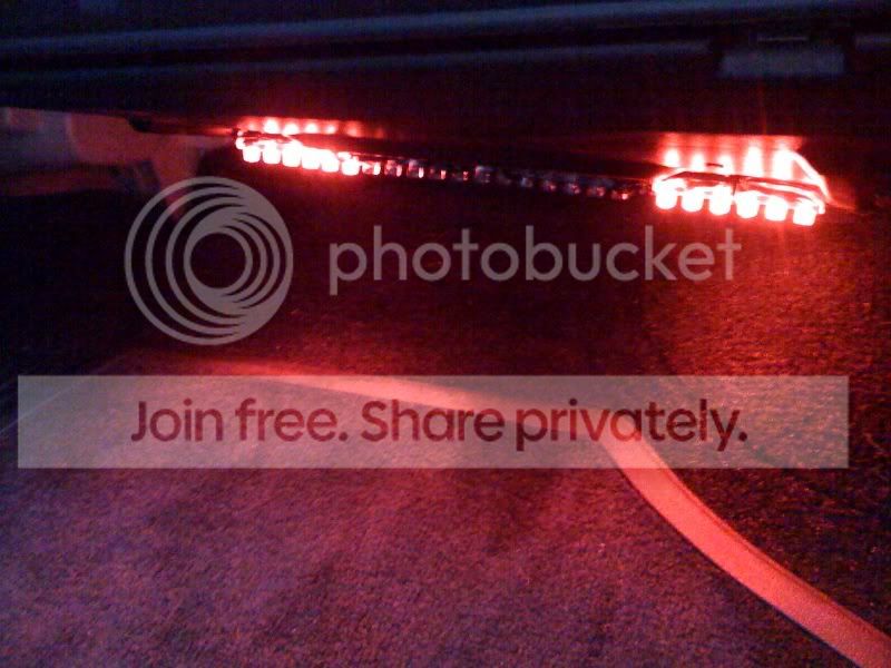

Nice! How did you get 2 different colors for footwell lighting? I wanna due blue and white...

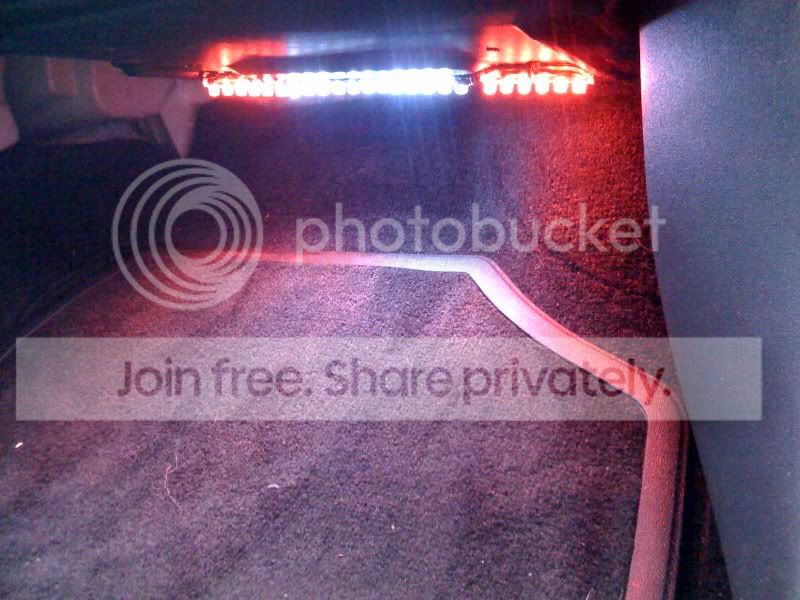

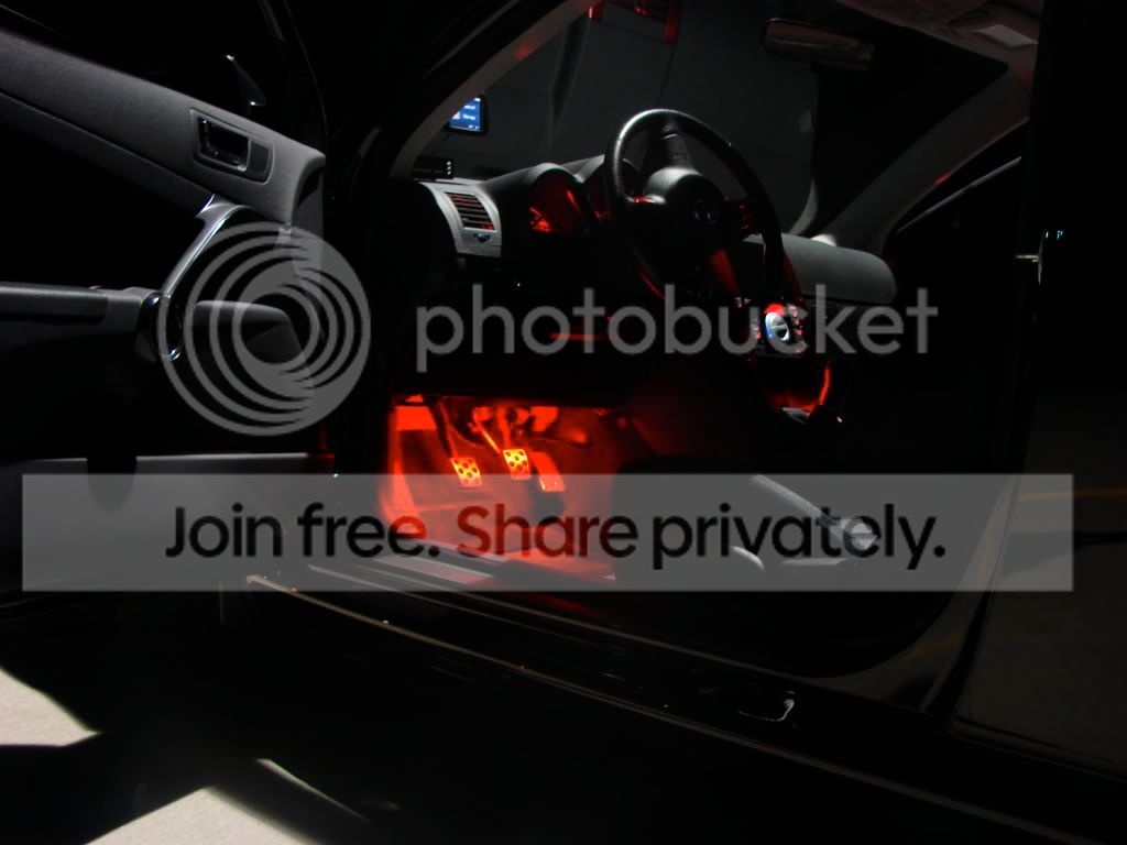

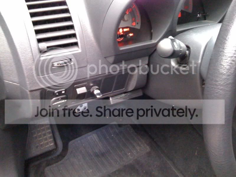

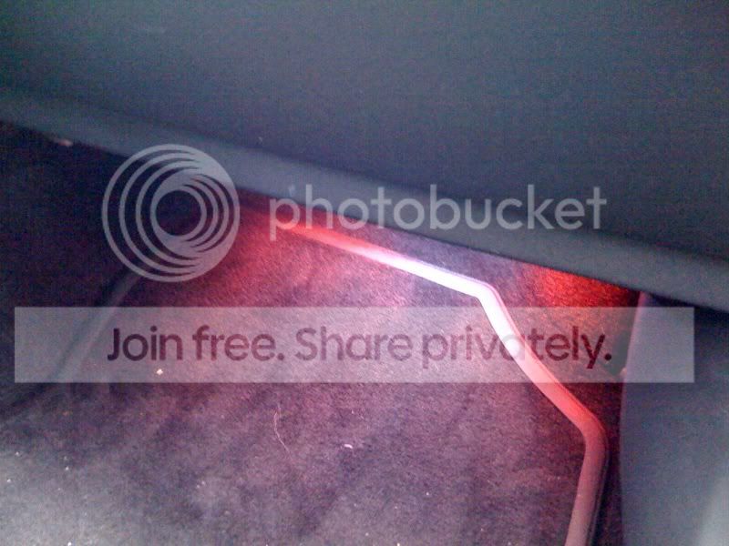

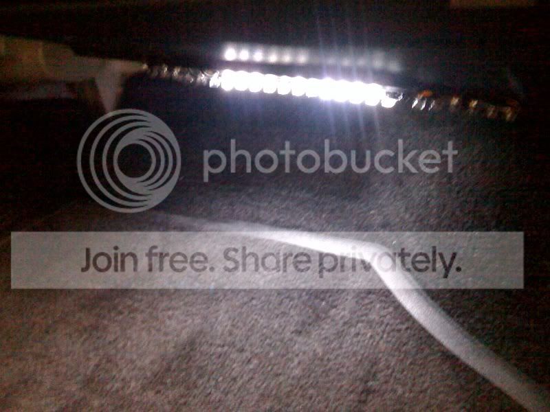

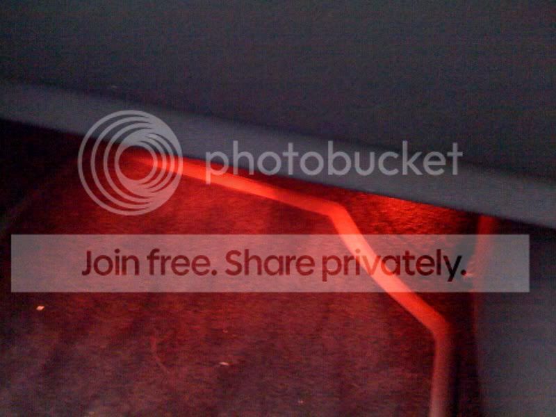

Well I used flexible LED strips from Oznium.com. in each footwell there is a long strip of white LEDs that is wired into the Dome circuit so that they light up when the doors are opened. On either side of the white strips there are to shorter strips of red LEDs that are wired to a switch on the dash.
I just ran out and took some pics for you:
doors open; switch on:
doors closed, switch on.

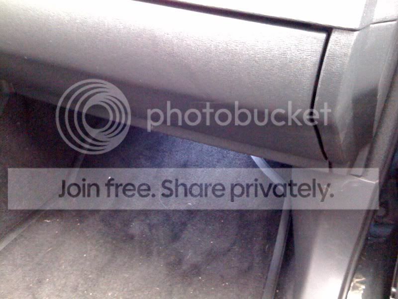

doors open switch off:
....the circuit for the white strips also has a switch in it just incase I want open door pictures with just the red lights...
the black switch controls the red LED's, the chrome one is a second switch to the white ones (the first one being the door switches)
whew okay hoped that helped, let me know if you have any more questions :-)

You installed the steering wheel upside down.
Old Nov 11, 2008 | 08:43 PM
x_Batman_x's Avatar
Posts: 2,111
From: New Orleans
I new some one was gonna make a comment lol.
yeah i didnt realize it was turned when i started taking pics
