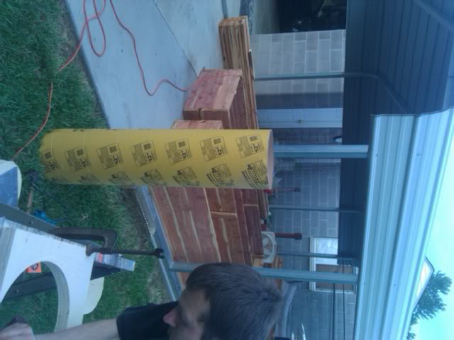

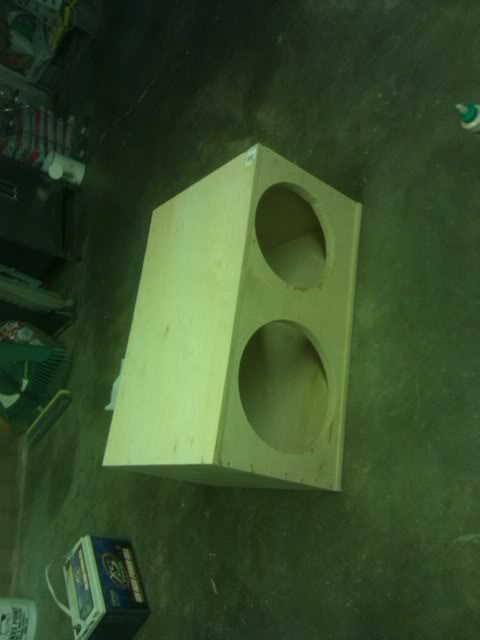

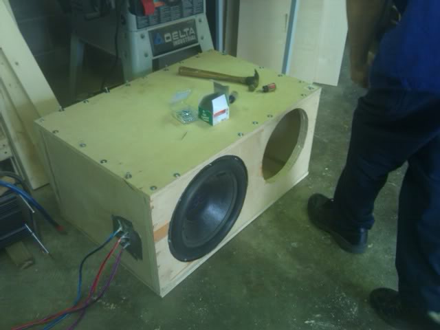

Well Imma start by answering a few questions.
Question - Will the Concrete form tube will Resonate. Answer - No, For some odd reason in physics some where is causing it to flex but not resonate.
Question - What is it tuned to. Answer - At any point we can change the box volume and port size to change the box's tuning, So right now it has been 34, 38, and 42.
Question - How many subs? Answer - well At this point the box is a test box and Is only currently using 1 15".
Question - Why is the car gutted and why so much ____. Answer - We both compete in Meca which is a which is a form of event we compete in; We both compete in Modified class that allows us to do anything behind the bpillar.
5 1/2 cuft net
4' x 12" port
1 - 15" DC level 4 w/ level 5 coils
1 - AudioQue 3k @ .4 ohms
