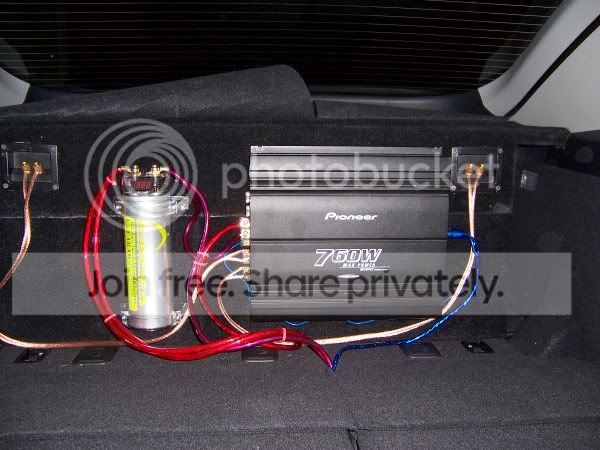

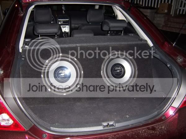

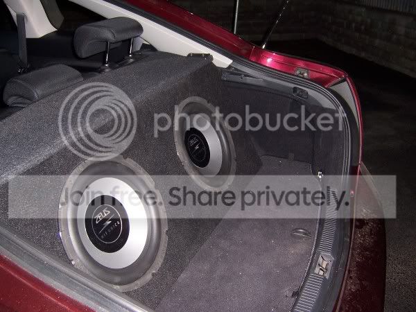

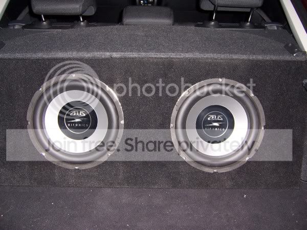

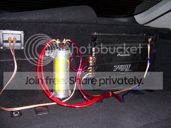

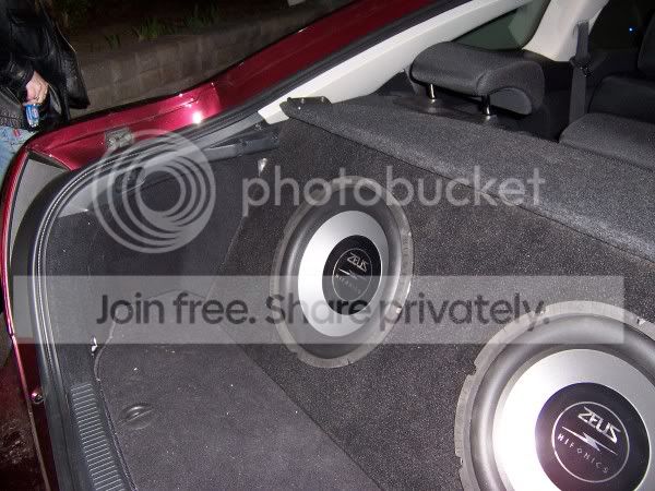

My boyfriend did this for me yesterday....
Pioneer DEH-P6800
Pioneer 760 Watt Amp
1.5 Farad Cap /w digital display
2 12" DVC Zues Hifonics Subs, 1000 RMS ea.
Custom Box (dementions: 35x13(base)x 14(hight)x 6(top) but the front and top peices are extended to meet the side walls)
here are some pics.....
Tell me what you guys think.....

loud

thats a little bulky for me...im not a fan of boxes in the back of the tC...gotta have that put in the floor bro...but loud never the less

looks nice I would have gotten a diff amp. I havent heard good things about it....

those must be severly underpowered. 2 1000rms subs and 760watt MAX amp. hope those subs dont get messed up. get a new amp.
Old Apr 4, 2006 | 10:11 PM
nodsetse's Avatar
Posts: 2,338
From: San Diego (Mira Mesa), CA
Nothing wrong with using that amp to power those subs, they won't be damaged unless the gain structure of the system is set improperly. Even then, all a person has to do is use common sense, and don't turn it up to the point of damaging distortion. It's not critical to match the sub's max power rating with an amp that can put out the same amount, so I wish people would stop implying such.

How much do you think that weighs???
