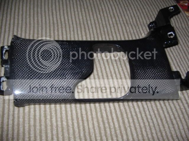

just got them yesterday and whats the easiest way to install

im pretty sure you have to unhook the seat belt to get them off

You'll need a some 12, 14, 16mm sockets, undo the bolt on the bottom of the seatbelt behind the seat, then undo the little clip holding the backseat trim in, pull that out, it's connected with clips, then you should be able to get to the b pillar. A bit of a pita, but it only takes me like 10 mins. PM me if you have questions.
Old Dec 30, 2007 | 06:25 PM
sddykstr's Avatar
Posts: 949
https://www.scionlife.com/forums/vie...light=sddykstr
check that out, good pics for what your doing.
