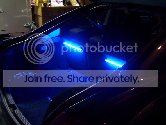

I currently have 2 12" Cathodes mounted to the back of my back seats. They are wired directly to the batter and have a switch.
I want them to light up when the hatch is opened. Like the cargo light...
Anyone know what I need to do this? Tool and stuff needed?
I heard I need a relay...
Help would be great!

I got it, no relay needed but thanks anyways. My problem was that I had ordered the cheapy cathodes made for computers a long time ago. Well the transformer for those kits do not have reverse polarity protection like my new ones from oznium.com
So It is really easy now it looks like I had planned along time ago!
