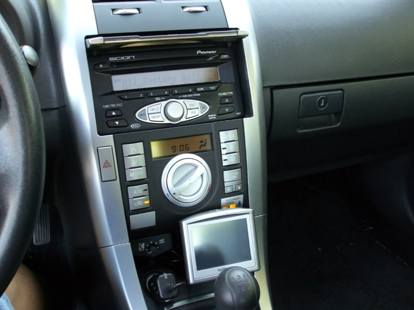

I don't think that the OP mentioned replacing the speakers, and he did mention that he's happy with the sound of the stock unit. It sounds like he's just adding an amp and sub for a little more bottom end to supplement the stock sound.
The speaker level inputs on the amp should be great if you're on a budget. Hopefully the amp came with a separate bass control **** that you can use to adjust the amount of bass... or you could just use the fader on the head unit to tweak the amount of bass that comes thru...
Here's what mine looks like... the bass **** is in the cubby next to the nav...
What I would recommend though is to use some passive crossovers to limit the amount of bass coming thru your stock speakers... they're a lil hard to find, but they're called "bass-blockers" in some areas. They just hook up in-line with your speakers and filter out most of the bass to keep you from blowing up the speakers. They're cheap, but effective.
Good luck on your install...
