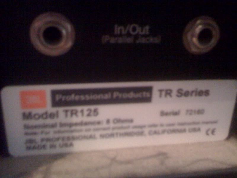

is it possible to use this for my car if I dismantle it? and given these specs, would it even sound decent?
JBL TR-125 Front-Loaded Two-Way Loudspeaker
Frequency Range: 55 Hz - 16 kHz (-10 dB from rated sensitivity)
Power Capacity: 225 Watts (Continuous Pink Noise EIA RS426A, 8 hrs)
Peak Pink Noise: 900 Watts
Nominal Impedance: 8 Ohms
Sensitivity: 99 dB (1W, 1m)
Nominal Dispersion: 90° Horizontal x 45° Vertical
LF Driver: 1 x 380 mm (15 in)
HF Driver: Pure Titanium Diaphragm Compression Driver. liquid cooled
Horn: Optimized Aperture™
Dimensions (HxWxD): 750 x 460 x 390 mm (29 1/2 x 18 x 15 1/4 in)
Weight: 27.2 kg (60 lb)

first of all, you're looking at a 15 inch sub, that's hella big for the rear space in the tC... you would need a huge enclosure to hold that thing in the trunk.
second of all, it's an 8 ohm sub, and most car audio amps run at 4 ohms and lower... the resistance would be too high to be anywhere near efficient... you could connect a 200 watt amp that 's rated at 4 ohms, but it will only put out 100 watts at 8 ohms... you would have to feed the sub twice as much power in order to get the same sound as a sub designed for car audio.
In short, I wouldn't recommend it, and it would only be a waste of time and money...
