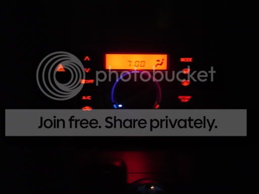

Thanks all for the help. Fishingexpert87 is da best. Heres some pic of his work. Sorry for the big pics. tryed to resize.

np man the results was worth the trouble
I really love how on the aircondition control **** it goes from a bright blue to dark red, it stands out alot
