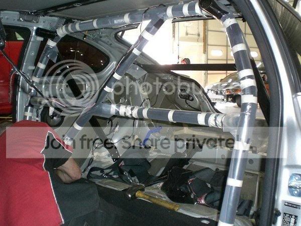

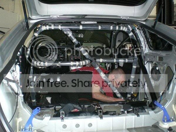

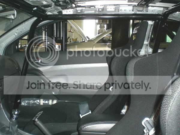

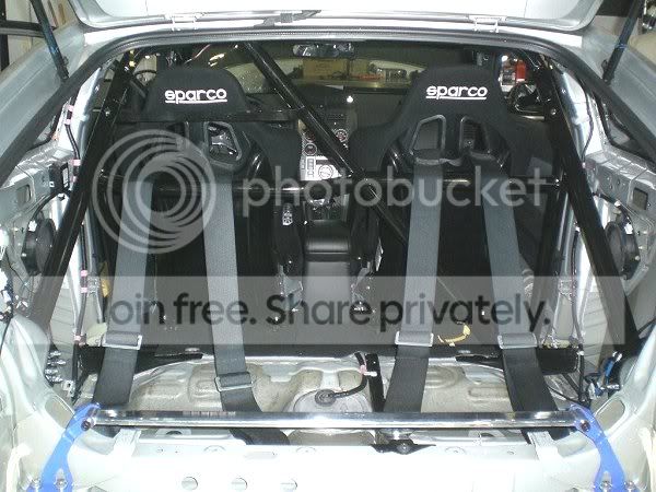

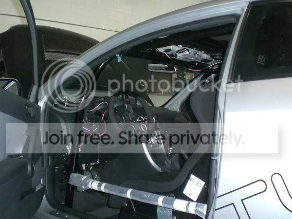

Just got some pics of the new cage installed. They did a great job! All the raw metal was painted gloss black and they gutted most of the bolts, brackets, and anything else not needed in there. I still need the speakers removed since i no longer have a stereo.

P.S. that little black bar on the floor in the last pic near the left side of the pass. harness an be taken out too.
and shouldnt the harnesses be crossed since they are attached to the floor...?
The harness is going across the bar to give it a lateral pull, so I imagine it's not necessary to cross when you actually have a bar to use it with.

yea The Simpson Harness actually has a horizontal centering web so it would be a no no to cross the shoulder belts. I retained the glass during the install as well as the sunroof function. Just as an added touch, I acid primed the sandwich plates which are underneath the car and wheel wells.... then undercoated them blending into the factory undercoating.
