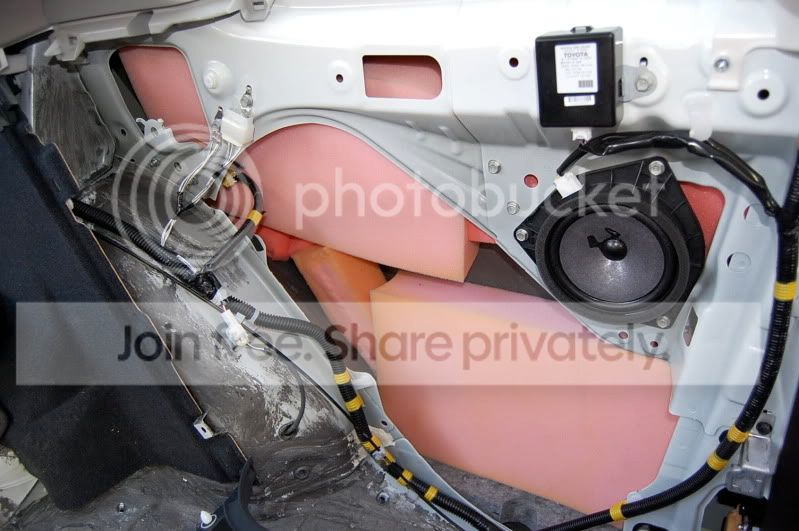

Also, since the rear seats deaden A LOT of outside noise, I suggest putting down some sort of new sound deadener. I used 1 gallon of liquid eDead, and put it under the spare/subs, under the rear seats, inside the rear quarter panels and inside the hatch panels. It did a pretty good job deadening my exhaust, it basically compensated for the lack of the rear seats. I also just added this crap that I got from work. It's just really thick packing foam. Since it was pre-cut, I just shoved it inside there.
