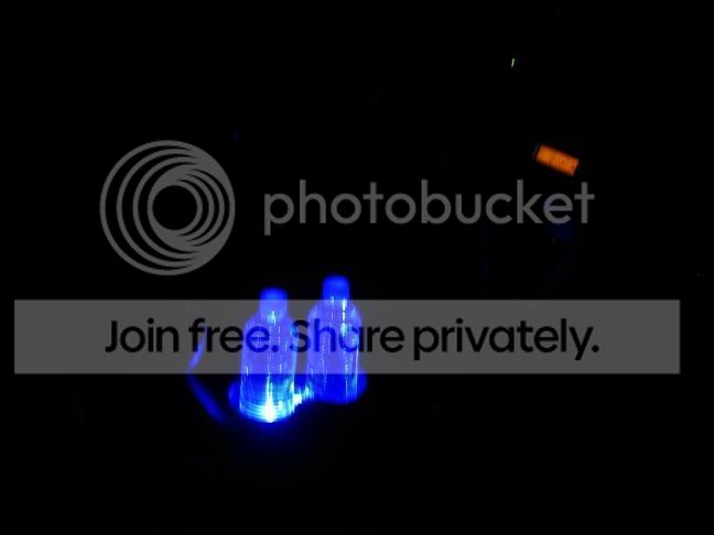

mattTc's Avatar
Posts: 627
From: Milwaukee Wisconsin USA
i just added 2 more LEDs into my cup holder so i have a total of 4 and it looks real good
