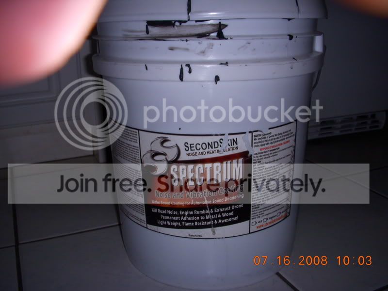

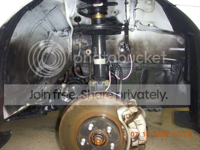

ok so ive been silently reading and no one here really wants to get rid of all the road noise that the Tc makes. So I went and bought 5 gallons of second skin spectrum to paint into the wheel wells and the complete underbody. I know alot of you will probably say it looks like a pain in the ___ but its well worth the money and time spent. Just doing this was just as amazing as doing the whole car with 80mil RAAMaAT and the neoprene stuff. The car is QUIET!
here are a few pics, sorry i didnt take any of doing the underneath the car.

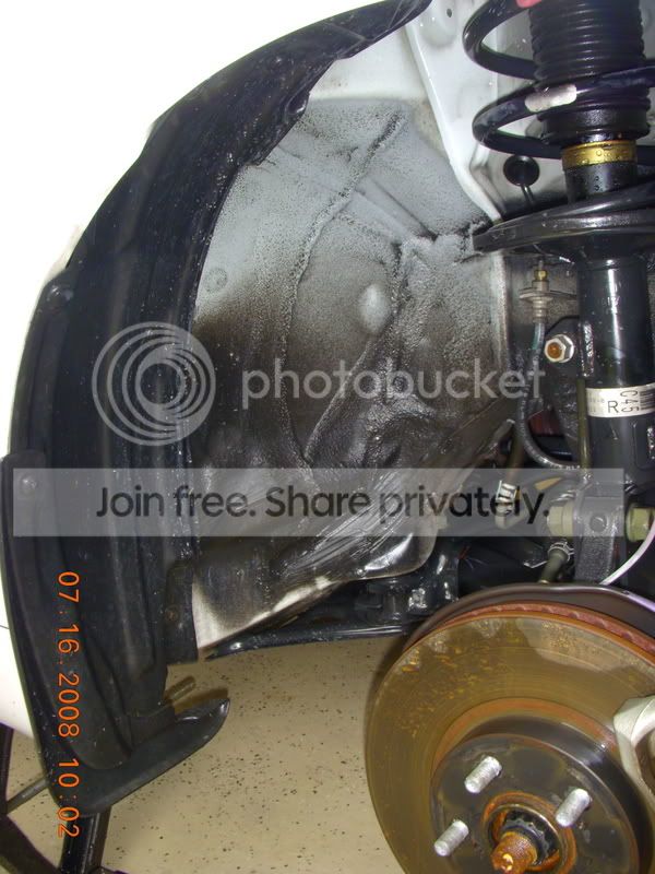

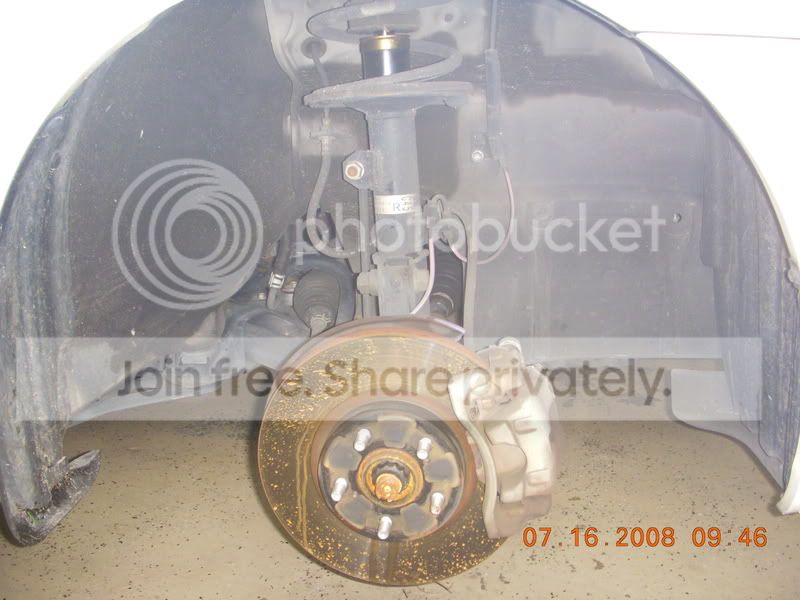

to clean the wheel wells all i used was DAWN and a old car wash mitt. wasnt too difficult just really messy.
after i cleaned them up i made sure everything was dry before i applied the SPECTRUM

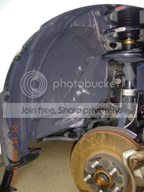

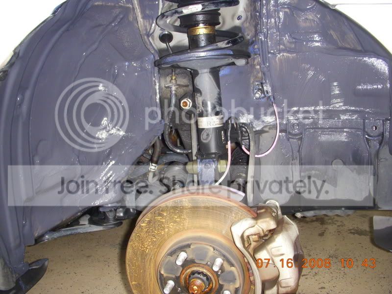

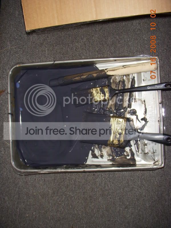

all i did was put it on as thick as possible. Well it only took about an hour in the hot ___ sun to dry before you put more layers on. Second Skin told me to make sure its at least 3-4 credit cards thick! Trust me I have done this to all the wheel wells and also the bottom of the car and i still have 3 or so gallons left! I guess I will go ahead and do more layers.

yes i did the entire underbelly of the car with at least 4 coats now. Also when it dries its black not grey. Plus you never see it unless you like looking at your wheel wells lol.
I bought the spectrum from a memeber on DIYMA FOR 250 SHIPPED. its normally 250 plus shipping from second skin

Why did you do the plastic fender lining? Any only parts? Looks sloppy.

ok number #1 think before you ask a question unless your just stupid.
Why did i paint the plastic liner hmmm well isnt that part of the wheel well? And im sure you would ask did i paint behind it also? Yes i did. Did i care if its sloppy or pretty hell no. I sound deadening the car because if you have never owned a european car or high end luxury car before you would beable to hear very little road noise because they sound deaded the ____ out of the cars. thats how i wanted the Tc to sound. So when i talked to the salesman at Second Skin he is the one who told me to paint EVERYTHING in the wheel well.

Question: when you did the underbody, did you do everything e.g. the area where the exhaust runs the length of the car? or did you just pick and choose certain spots? How long did you let this dry before driving? Sorry if I missed that in previous or original post. yups!

Anyways, good question. I jacked up each side of the car and washed the belly first. Then dried it off and started with the panels closest to the exhaust, i didnt feel like taking the heat sheilds off the exhaust not dropping the exhaust to paint in that area but if i do get more time i probably will. You will have two huge areas to paint under the car and if you can try to fill in the gaps and cracks with alot of the paint. This seemed to make the car alittle stiffer.
I live in Florida and after i painted a layer on the car i would let it dry for about an hour and if it was tacky i would wait another 20 mins before i layed another layer. Also the Spectrum is water based so you dont want to do it on a rainy day! LOL

good idea, but if you painted over any bolts...GL getting them off in the future. lol
