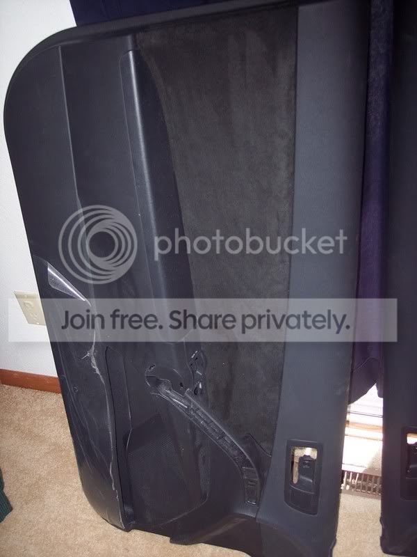

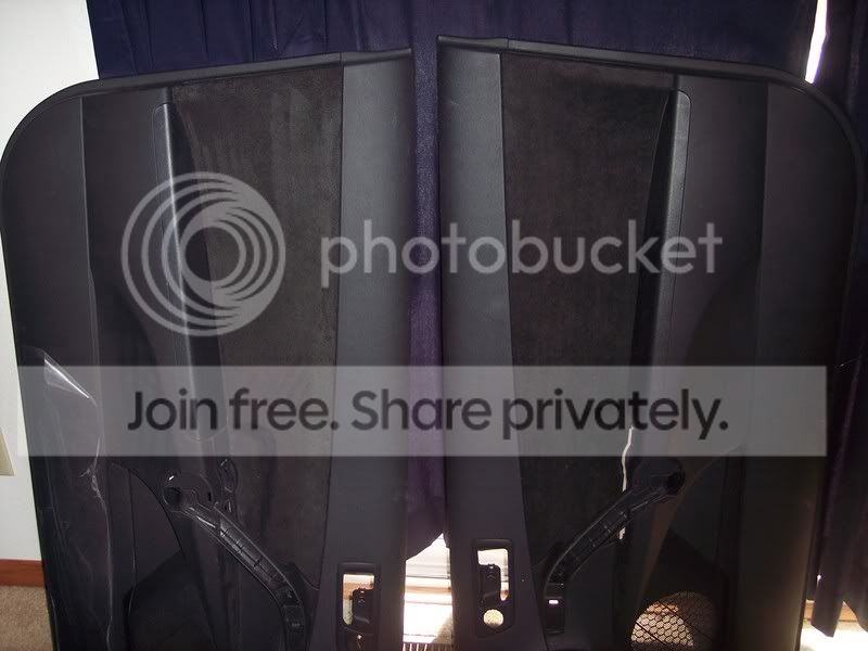

just got done wrapping my doors in my suede and after 3 hrs this is what we got.
i'll take more pictures when i get them in the car.

how you go about that, i was thinking of doing mine in a blue color vinal with some stiching done to it. you use spray adhesive to lat down the suede?

you have to remove the plastic rivits (_____) and then pull off the stock stuff, then sand it down smooth and apply the new stuff with headliner glue.

then replace with new rivits?

yeah it does. and i took little self tapping screws to put it back together. rather than melt plastic on it.

awesomeness dude! what adhesive did you use? 3m #90?

yep just put it in the car. was gonna take pictures but the camera died. let me just say it really sets off the car. a lot more than i thought it would.

got pics of the back of the doors?

doing the back doors next. will take pics when those are done.

whoops. i meant pics of the backing of the front panels.
