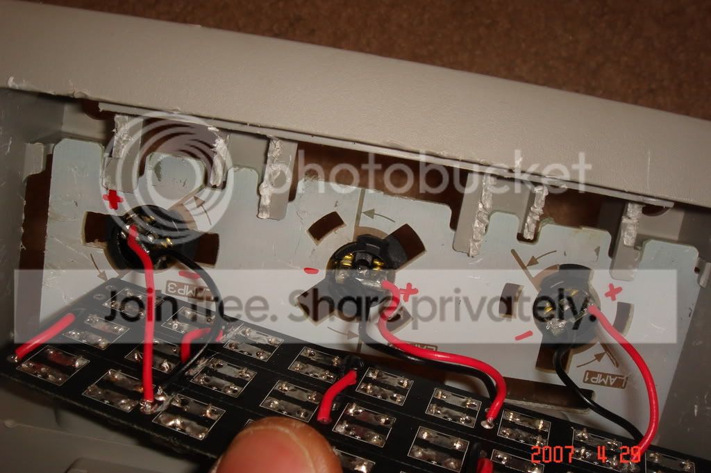

1. Front dome light

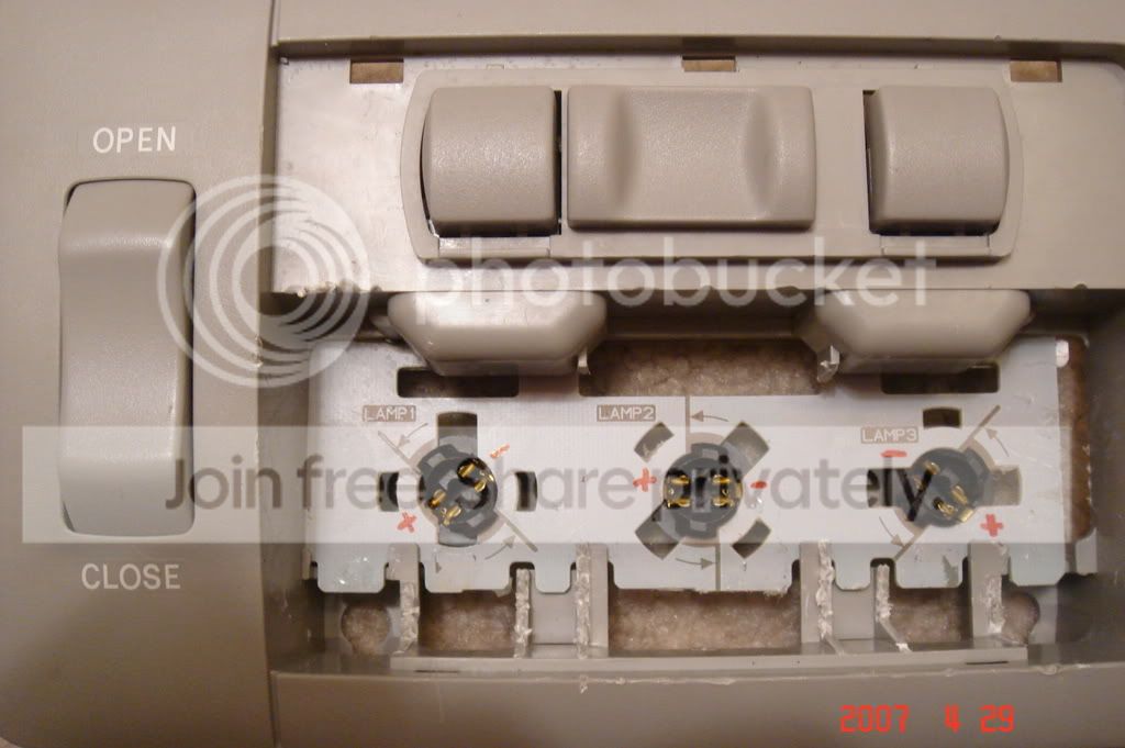

Break some plastics inside and pull out all three bulbs. Mark (+) and (-) as you see in the picture.

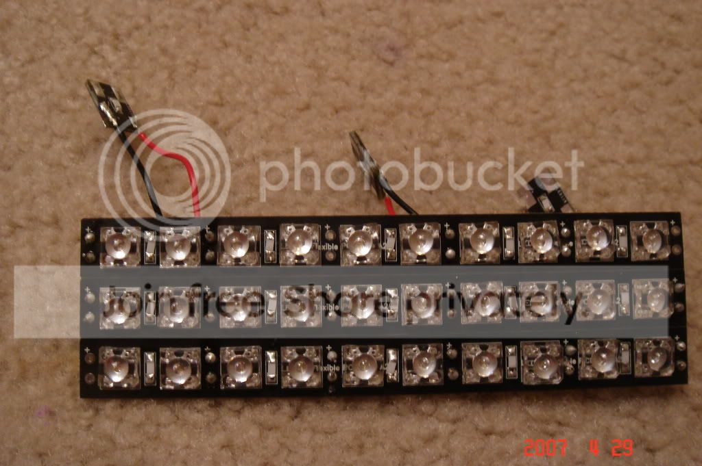

Now you are ready to install 30 LEDs PCB.
Put three small PCB into each bulb base. Red wire side has to go to (+) and black wire side goes to (-) as you see in the below.
Bring it to your car and hook up connector and then check all buttons and see if it works. on/off/door.... If anything doesn't work, check out all the wires connected properly. Red goes +, Black goes -.

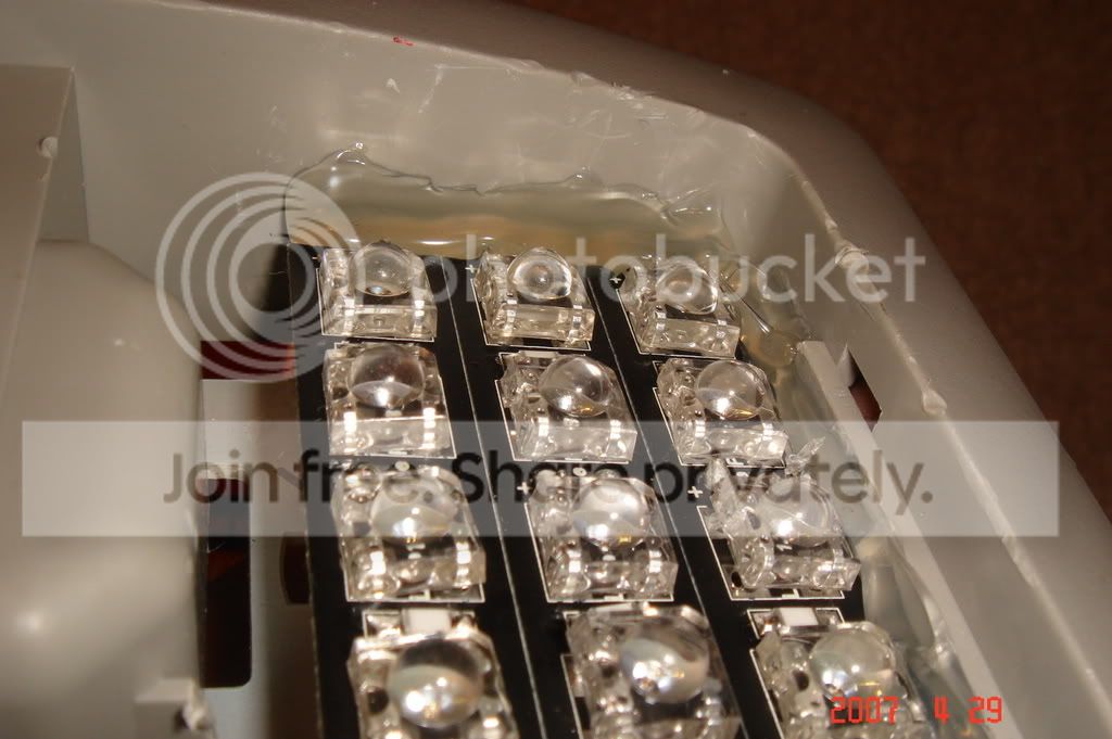

If all work, bring the housing to your working desk, and glue PCB like below picture.
Finally.....

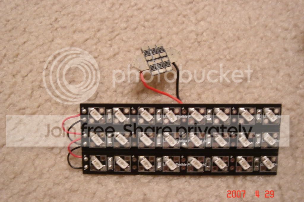

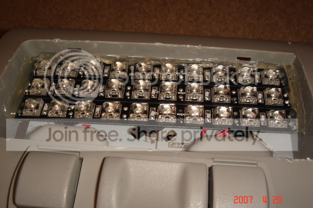

For rear, superflux is not available because of lack of space in between cover and plastic body, and so only SMD type LED can be used. I used 3 chip 5630 blue LED(total 24 ^^). Actually it looks much brighter than 30 superflux in the front. As you probably know superflux has only one chip, so total number of chips is 30(front) : 72(rear). Anyway here's some pictures.
Before the installation, I compared it with 9 LED bulb.
light of 9 LED bulb is like just straight, but mine is much wider and brighter.
Rear LED kit looks like this,

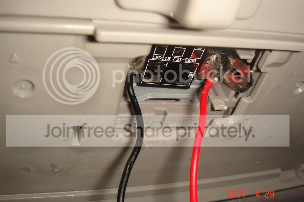

Before you glue PCB on the housing, try to test it first as follows.
Black wire goes to passenger side, and red wire goes to driver's side.
You'd better bring rear dome housing to fix PCB on it by glue gun or 5min Epoxy.
Then bring it to the car and put terminal on bulb base as follows. Black wire goes to passenger side, and red wire goes to driver's side.
Then everything's done. It's sweeeet!
