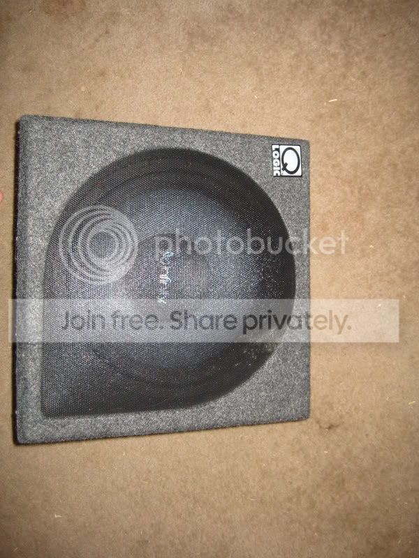

what sub do you recomend for this box-rock/rap wanting tight

this is a Q-logic box for a 12" sub.right now it houses a infinity reference 1211W sub.i dont know but to me it sounds like ____.i have a jl w0 10" in a sealed box in my truck and it puts this 12" to shame.what would you say is a good sub for the space that gives off nice tight bass

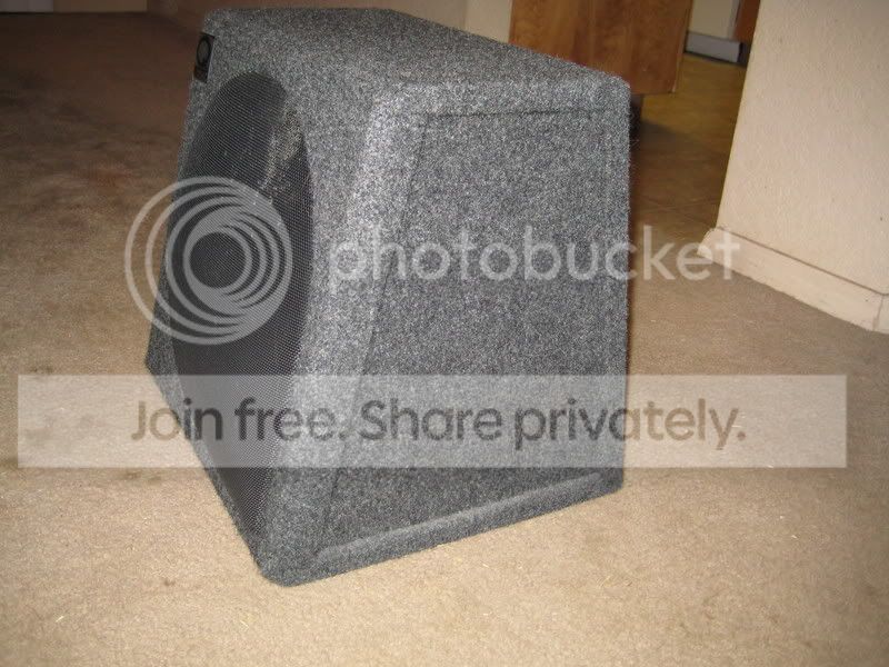

im more interested in using the box than sub.
its 15" wide x 15" tall.the base is 12" and the top is 9"
im not good at figuring ou what subs work in what box.
ok,the inside has a sticker that says its .85 cu ft of space.what would be a good sub for that amount of space
