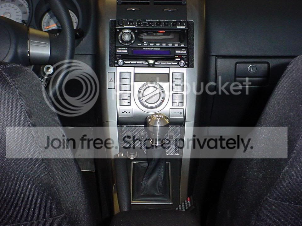

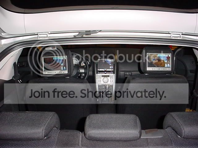

here is mine..
2 in headrests and then the dash
2 in the doors..
2 in the back..
I ran new wires to each seat. You can ground it right there. Just make sure it is a paint free surface. If you look close in this last pic there is a switch panel in there.. 1 is for the neon, 1 is for the stereo, 1 is for the monitors and 1 is for the nitrous. That way I have control of when my monitors are on and off.

Where did you get that carbon fiber cover under the console? Looks sick.
