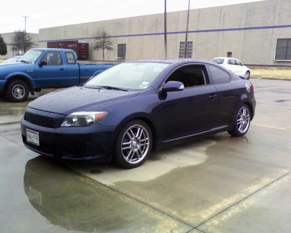

1. I have the H&R sport springs on my tC and they are right at/just under the 1.5" drop your looking for.
I had the the TRDs before and were nice at 1-1.25 drop all around or so, no way would i say the difference between the front and rear drop is as drastic as mentioned above.
here is an old photo of my car on the H&R sport springs with stock wheels
2. as mentioned above, the trim is part of the whole glass assembly, using adhesive is the best bet at repair without replacing the whole thing.
