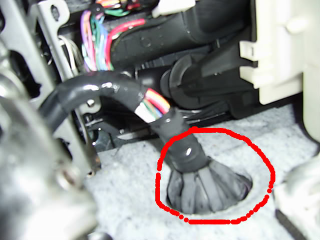

Hello, did you got this car used? Maybe the previous owner ran some power wire for their sound system, and he damage or moved the engine bay grommet.
( I was lazy and move that grommet to ran my cable the first time. I feel cold wind coming to my legs in the Winter time. )
Put your head near the gas and brake pedals, look up. You should see this
You might just need to move that back in place to cover the hole.
