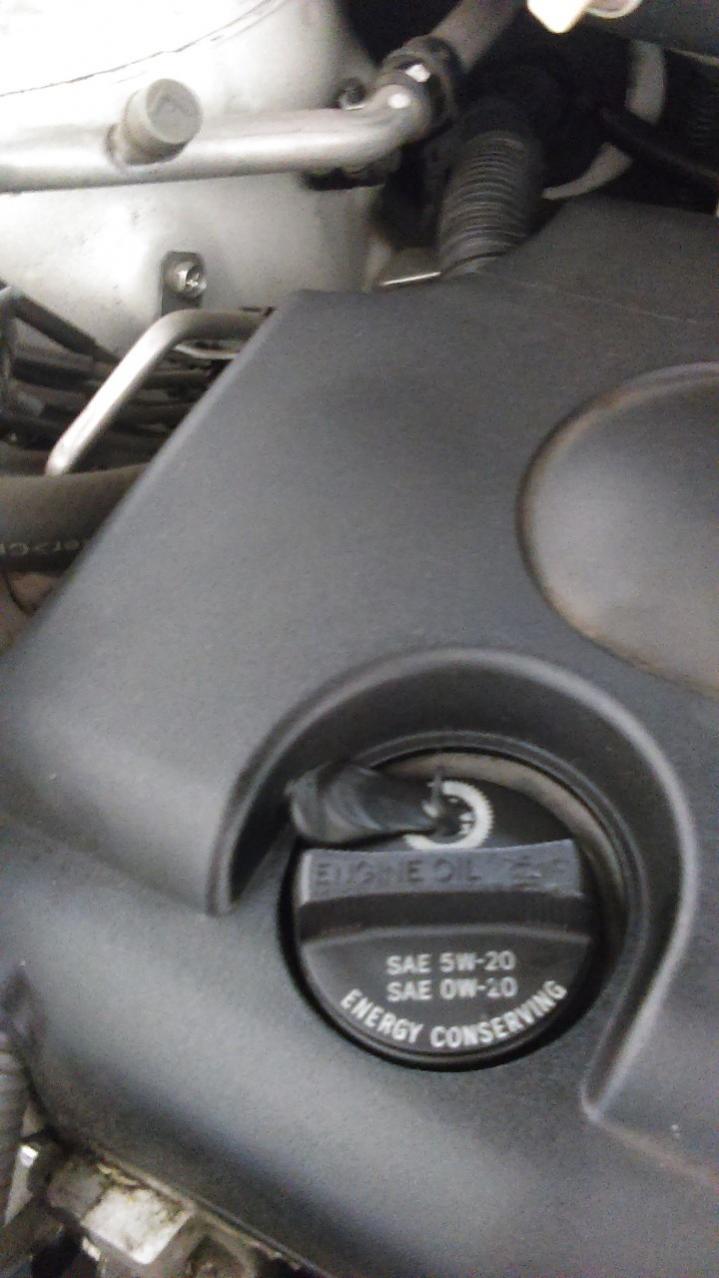

This is what the goo is they put on my dip stick and oil cap looks like...
same stuff is on my drain plug
Attached Thumbnails Anyone esle get the Warranty Enhancement Program??-imag0243.jpg   Anyone esle get the Warranty Enhancement Program??-imag0244.jpg

I just took mine in today, same goo
