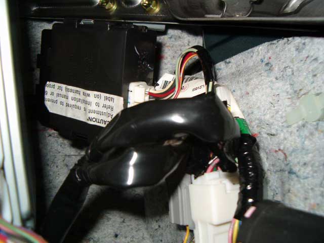

Just got home from the dealership. As i go and pick up my car around 12:30 the services manager told me that when my car had gotten there, he made the alarm go off by tapping the window with the key. I believe that that is a lie, if that is true then i would of heard the alarm and im pretty sure no thief would sit there n still try to break in with the alarm going off for 90 secs. So he told me he had his technician set the sensor level from 6 to 8. Which is pointless because when the window gets broken no matter what the level the sensor is on the alarm should go off. So i ask him "Am i able to adjust the sensor myself?" he says "No you cant, only 5 dealerships in the area are able to do that". So I get told all BS from this guy, and my friend starts asking him questions and he asks him "are you the owner of this vehicle?" My friend replays "no" and then he says ok i have no business dealing with you. But anyway he told me i should get my lawyer and call the corp. and what not thinking his is some tough s*** that knows his right. So I leave ____ed off, get my keys and go out to my car n try to tap on my window with my key. I was afraid to tap it even harder so I go inside and his him to come and do it for me. He gets his technician to come out and do it. He does it and it goes off. So while this guy pretty cool I ask him the same question am i able to adjust the sensor of the windows myself? He says yeah of course you can and shows me where the sensor adjuster is at and everything. So basically the service manager told me a LIE in front of my face over something so small.

You should totally do a DIY on how to adjust the sensor! I've tapped on my window, and the alarm doesn't go off. I'd love to adjust it to make it more sensitive.

There is a thread on how to set the sensitivity yourself. Its normally on the passenger side underneath and to the right the glovebox next to the ECU. Its a black box and on one side there's a hole and it has numbered markings on it from 1 to 10/11. I set mine to 11 within the first few months of getting my car

^exactly what gjpjr84 said. Right next to the ECU behind the glove box, and the Service Manager would not even admit that. I'm thinking about going back up there and just telling him is one of the biggest liars out here.

Is it in the same location on the gen1 xB's as well? And is it just a dial **** you turn to increase the sensitivity?
