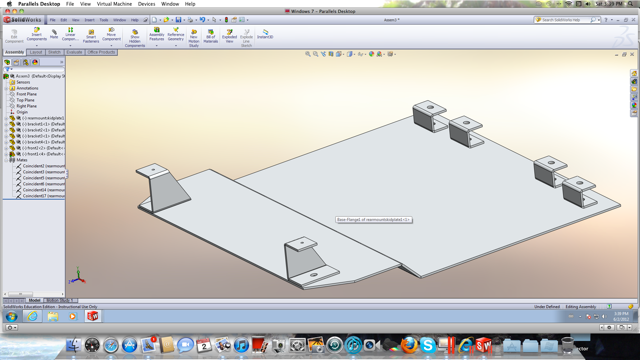

here is a rough assembly of what were are thinking about and how we are thinking of mounting it (weighing in at about 14 - 17 lbs). The design is not set in stone, but if distributed there will be no drilling required and all hardware will be included. We will be working with some material in the next couple of weeks to get an actual prototype built.
Hope you all like it, let me know what you guys think.

yayea solidworks ftw. looking good so far

Where is it going to bolt up to? I know its for the oil pan

from the looks of it, the 2 front holes are going to go were the front bumper tabs screw into the bottom part of were the radiator lays on top of. thats what it looks like to me i could be wrong.

no that is correct Skeet!

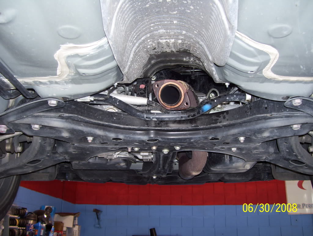

the rear portion of the skid plate will be mounting to the subframe crossmember (as there are not many places to mount underneath the TC) right where the suspension is hung from.
