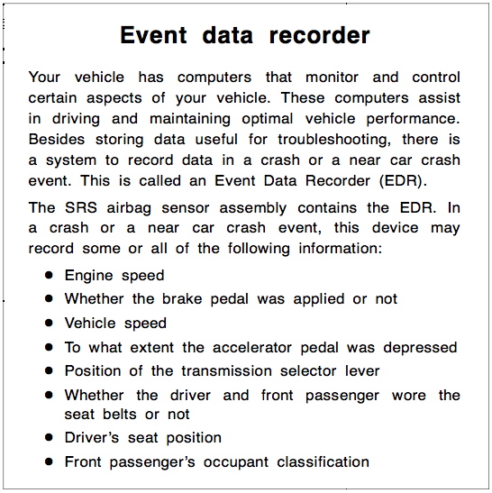

This is directly from the introduction of the tC Owner's Manual...
(IIRC, the airbags will not deploy if the seatbelts are not in use.)
Insurance companies and increasingly law enforcement are interested in what the "black box" (Event Data Recorder) has to say about the last 5 seconds of driving...
