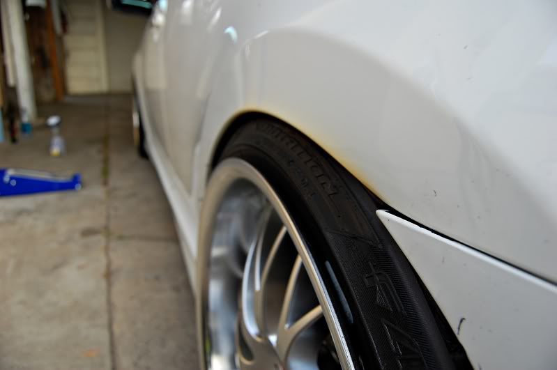

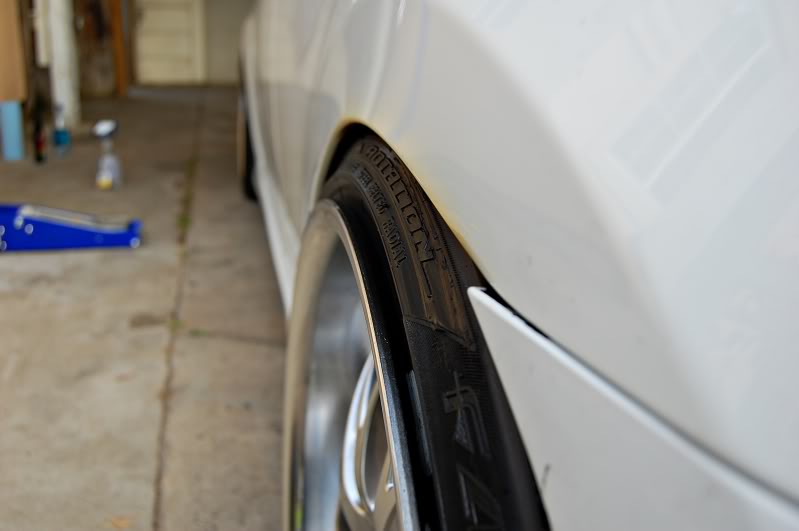

My ____ was mad rubbing and it burned my fender....now its yellowish. So I cambered it some more and still rubbing. Might have to camber some more! ____en sux! The price to pay...

holy smokes! lol
didnt know that was possible! sucks!

I drove it not even that far and when I got back home my bro was like is something burning and he was inside the house thats how bad it was rubbing...rubber everywhere and no women in sight!

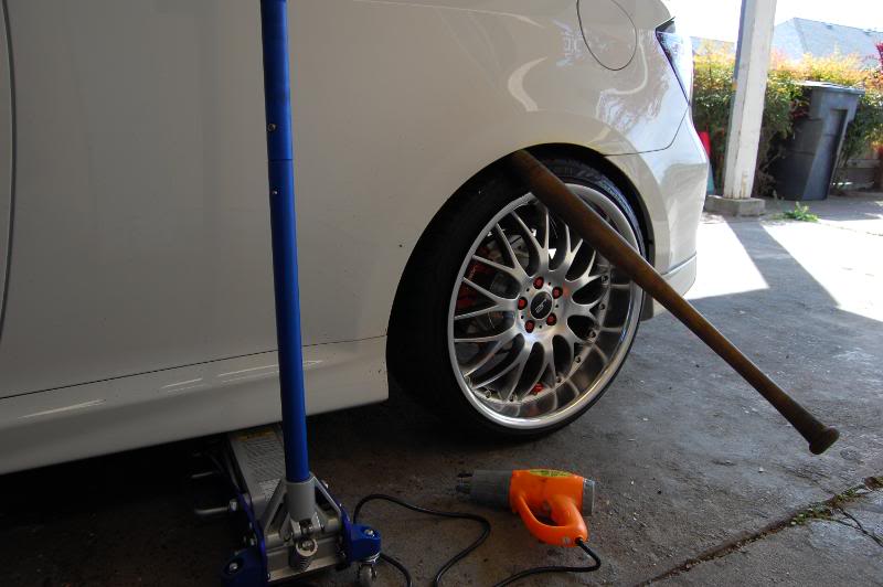

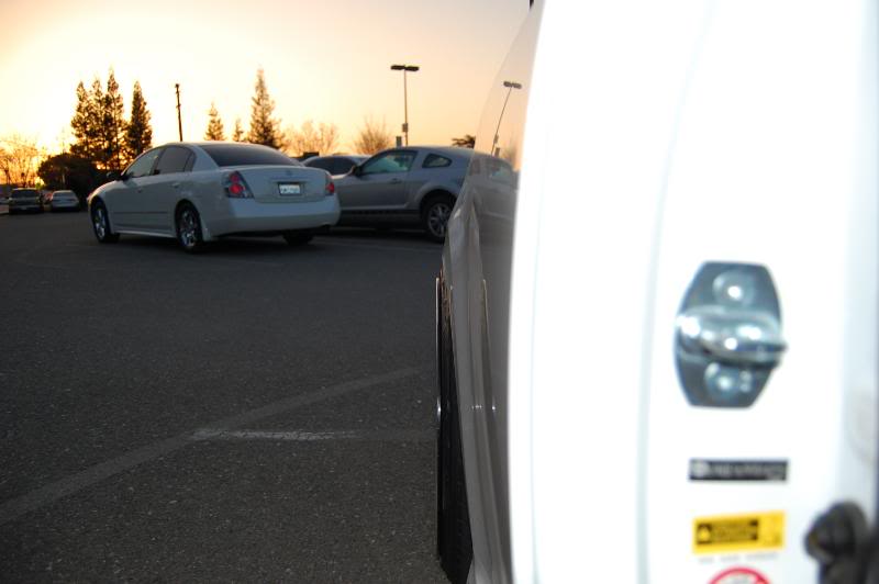

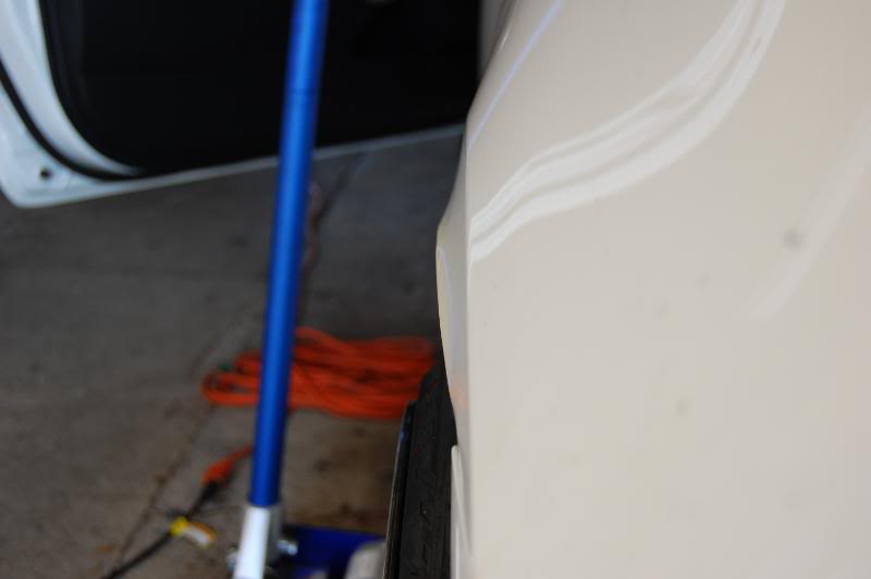

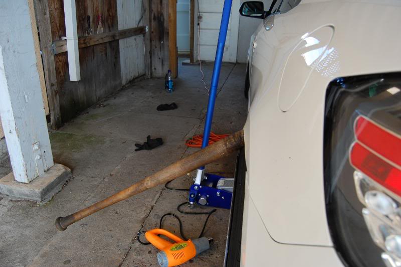

So after my little fender problem I ended up flaring my rear lips a bit, to give my rim some room to breath. Round two of bat vs fender..
Before..
Process..

Rub..rub..rub..burn..burn..

How did you not crack your paint pulling the fenders like that
