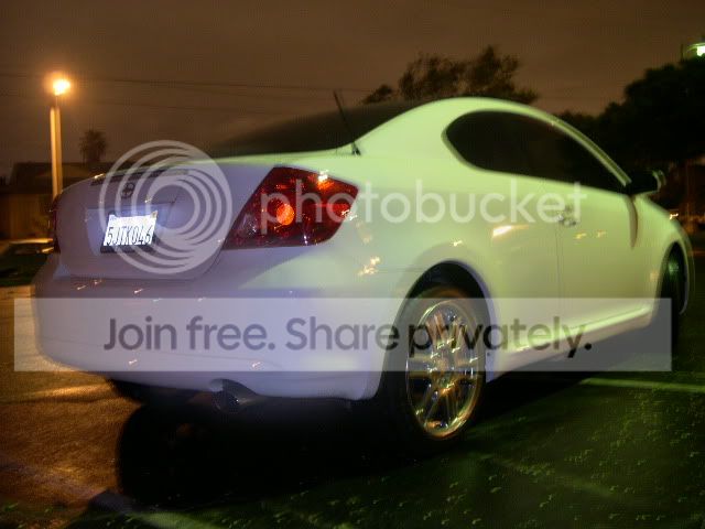

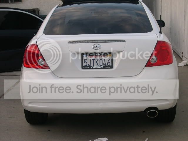

Here's how it looked from a couple feet back and after a little waxing to get some small scratches out.
A night shot. You can't really see it unless you're looking for it. There's stilla small circular dent.
There you really can't see it. I just have to always take pics while shaking the camera. It's okay, that's where my model will stand – covering the dent.

Even though I was probably the only one who noticed that the dent was still there, I was determined to rid of it even more. I took the advice of some guys that replied here and took a heat gun (my blow dryer) AND some hot water with towels. After burning my hands a couple times this is how it turned out.
It got a little bit more of the big bend out and the rest of it is pretty much gone. What I sorta noticed tho is that it sorta warped my bumper...I don't know...the pictures here don't really show the dent at all anymore, but you'll notice it if you really look at the pictures. Sadly, the dents are still noticeable and are not totally gone...yet...
