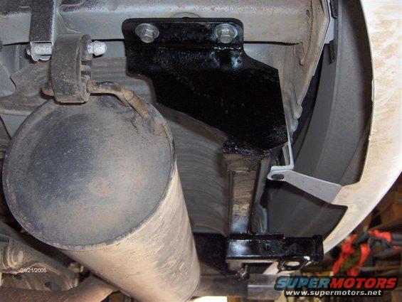

I haven't used that one. But I did make my own hitch. I assume it will use the same mounting points as mine. The driver side has nuts welded in the body, the passenger side has holes but no nuts. It should come with inserts to bolt up the passenger side.
