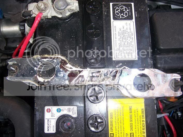

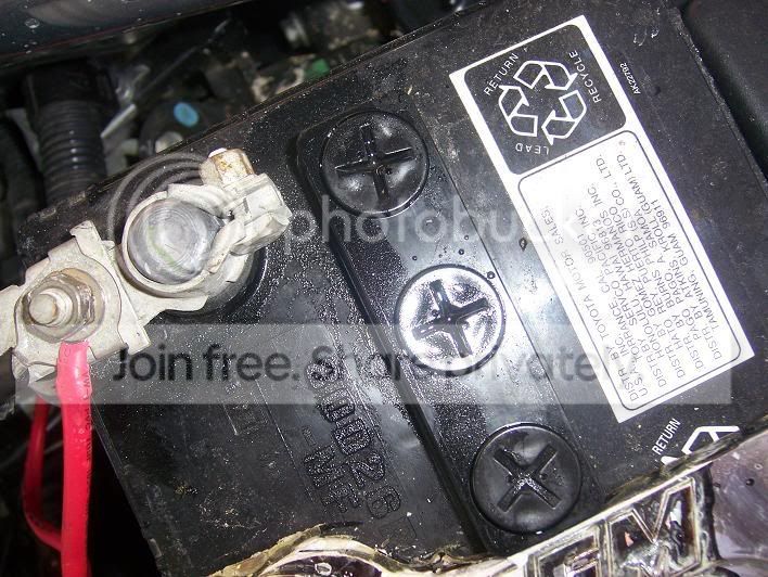

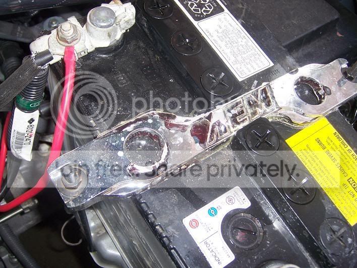

ok, my battery is leaking and its melting my aem battery tie down, do i need a new battery or can something be done about this one?

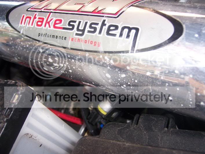

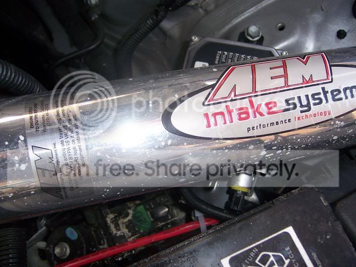

also there are some white spots on my intake that don't come off idk if this was caused by the same problem
any input on this would be appreciated, thanks guys

i dont believe there is anything that you can do about a leaking battery so your just going to have to get a new one

looks like the refill caps are a bit loose, they should sit flush to the surface. Try tightening them down.

^^^ i tried that too, didn't work

Is your intake stainless steal? you should get some polish or stainless steal cleaner and buff it out

Um duh. Get a new battery damn. Dont ever just let battery acid go everywhere man.

get a new battery and use 7up to get the acid corrosion off

new battery yes, but how is 7up, which is acidic, going to clean up the acid, use baking soda, its a base, it'll neutralize the acid, and make cleanup easy.
