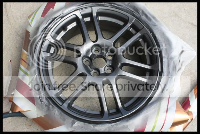

Week 2: Tired of the curb rash sticking out so much, I decided to paint my wheels. Began the process with stripping the wheels to the metal. Then wet sand, prime, wet sand, paint, wet sand, clear.

i would honestly repaint those wheels.. it doesnt match your color. everything else looks fine though

Would you go darker or lighter? I think my camera phone doesn't do it justice, I'll take better pics tomorrow with a digital camera.

yeah it looked fine on the pic above it.. maybe the digital cam will help :D

I would also recommend repainting those wheels. Adding a gloss would add a shine to them. And save your $$ for a drop. Good start though

definetely add a gloss to the wheels. makes them look so much better.

if they look more like the ones in the first couple of pictures after the paint job, then I like them, if they look more like the last picture,I would go lighter. or yes, like everyone else said, make em shiny. I don't know though.

Why would you use aircraft remover on your wheels? Just scuff up the wheels with 800 grit and paint.
Fix the curb rash, wasn't that the point of doing the wheels?

Good start so far man.......but yes glossing the wheels up will make it shine a bit more or re-paint bronze or gold.....look good with the color of ya car IMO

repaint them bronze. looks good tho, keep up the work.

Aircraft stripper is a breeze to use, so why not use it to get a good base for the primer? I reduced the curb rash as much as I could with a wire wheel and 400 grit wet sanding. If the tires weren't mounted I would've been able to do a better job on them. I used Duplicolor wheel coating as they recommend on their how-tos. I suppose it doesn't show well. I am hoping that the wheels are temporary until i can get a nice set of 18"s come this winter.
I agree with the bronze wheel paint, i just can't find it anywhere in my area. And I also tried while I was across town in Kingwood and didn't find it at Napa or Autozone. If I repaint it'll either be gloss black or bronze.
