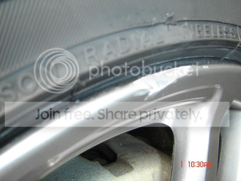

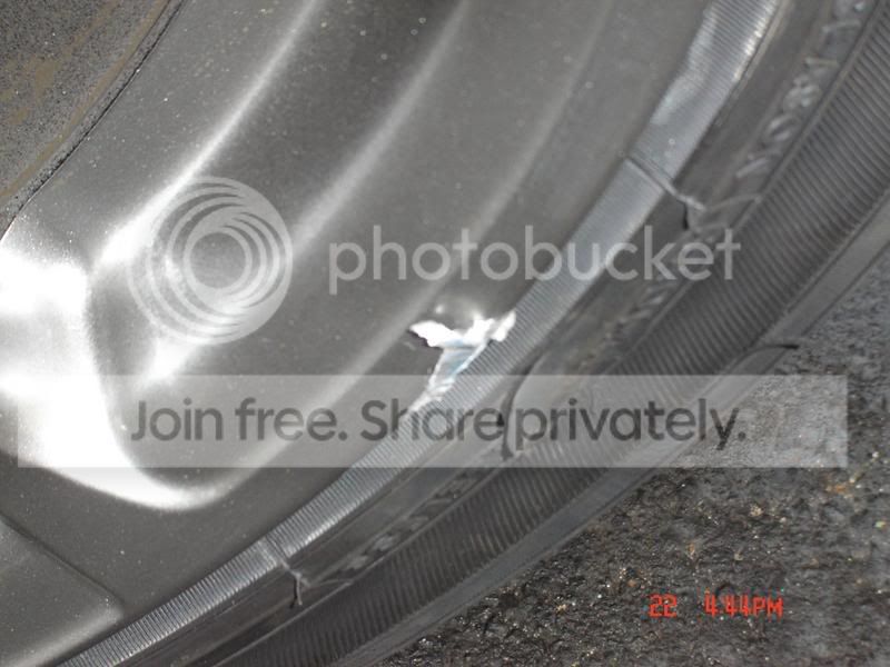

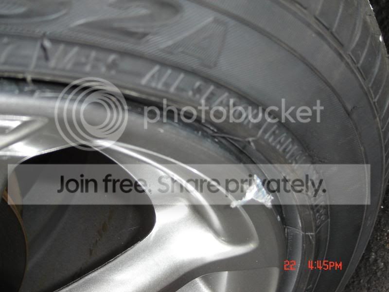

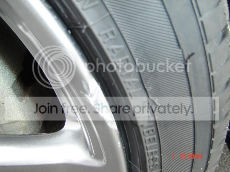

Early January, I got into an accident on the highway where my rear tire blew out and caused my car to tumble onto the driver's side. So, damage was all of the driver's side, all rims, and that tire that blew out. Statefarm covered me and all I had to pay was my $500.00 deductible. I'm in Gainesville, Florida so Gatorland Toyota repairs my car. The day I went to pick up my newly repaired car, I inspected what I was told was supposed to be repaired. Driver's side looked great to me. I checked the passenger side rear tire that blew out and it was replaced. Great.
I drove my car home and decided to check over my car once again. But this time I noticed something that I didn't catch at the dealership. My front passenger side rim and tire had this nasty looking tear in it like so:
It's as if something really sharp and sliced that section of my rim and tire, right?
So I contacted the dealership and told them about it. I brought my car back the next business day. The person that was assigned to my car took a look at it and denied that it was their fault and that I must've hit something on the road (which I didn't, and I can't find a way that something would slice my rim up like that while driving anyway). She would not take it back to fix or replace it. Instead she said she'd call a Statefarm rep. to come out and take a look at it the next day.
The Statefarm guy came to my house and inspected the car. Apparently the rim was not the only imperfection to the car. He found things that were unscrewed and loose under the car. He found half-assed paintwork around some edges of the car, scratch marks on many other places. All in all, it seemed the guys at the dealership did not do a very good job finishing up the job on my car. So Statefarm has Toyota take my car back in for corrective repairs, where they replaced a rocker molding, screwed back all the loose ends, re-painted the things that needed to be re-painted, etc. However, I was not contacted by anyone telling me what repairs were going be done. I was under the impression my rim and tire would be replaced as well. But, no.
When I went to pick up my car once again after the corrective repairs had been done, the rim and tire were not replaced! Nor was it even 'repaired'. I'm guessing they convinced the Statefarm rep. that it was not their fault or something, I don't really know:
All they did was shave off the piece of metal that stuck out. They did not even attempt to clean off that blue stain on the metal. The tire is still in flaps. Now I notice my tire pressure light is on. I'm not sure if that's linked with this problem, but nonethless, this is really upsetting.
My point is, what am I to do now? How do I get them to replace my rim/tire because it is my understanding that I'm supposed to get new rims after repairs. This rim might be new but it's damaged, coming off the dealership's lot.

if your tire pressure light is on how about checking your tire pressure? If it is low you might have a case against them if it causes your tire to lose air.
My issue is that rim looks like it could have been run into a curb by a driver. Which is probably what the stealership argued.
Based off so little information you might have to eat that wheel.
Take it to a real body shop. I avoid dealers like the plague, the sheer amount of misinformation I have heard people get from "certified" techs is ridiculous. I know there are some that are ok, but the ratios of bad to good im my experience is high. My dealership seems to be ok, but I do all my own work unless it is a warranty issue on all my cars.
You really should have picked a good body shop to take it to in the beginning. But now you are stuck with these guys. For the wheel, it is going to take some arguing, I would try to get Scion customer care involved. For the shoddy work, you could have it inpected by a good body shop and argue it that way I guess.

In person you could tell it wasn't hit by a curb. It was definitely sliced somehow by an object.
When the dealership checked it out, they too agreed it wasn't a curb that caused that.

I know exactly what happened. The person who put the rims on probably didn't lubricate the bead of the rim to assist in it going on the rim. The tire caused to much tension and the tire split at the same time the machine gouged your rim. If it's a NEW tire, it wouldn't magically appear...notice the blue scrape in the rim that looks like paint transfer?

Having worked tires before, I'd agree with the other guy that the guy on the tire machine screwed it up. Check the color of their tire changing equipment. By the way, chances are it's a darker blue than the transfer on your wheel, as the bright silver aluminum is going to lighten the color.
