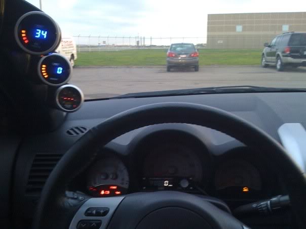

superl33t custom gauge pod

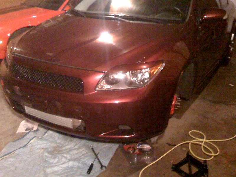

eyelids and intercooler fitment
4/1/09

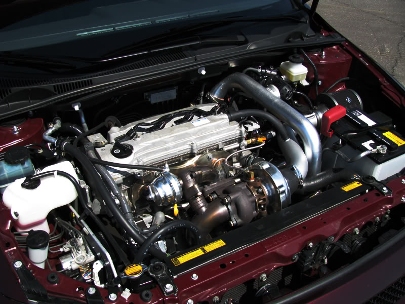

4/17/09 Install complete
a real gauge pod.. LOL
tune on 8psi Bumped it up to 9psi a few weeks later

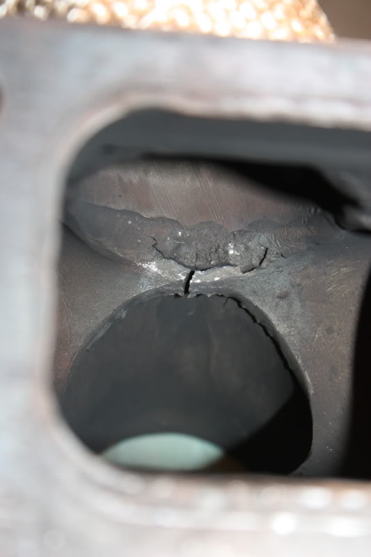

after a few months of heavy abuse and tons of backfiring my manifold was about shot

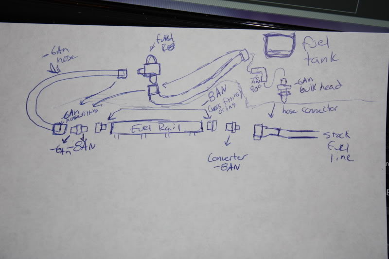

layout of new fuel system getting installed this winter

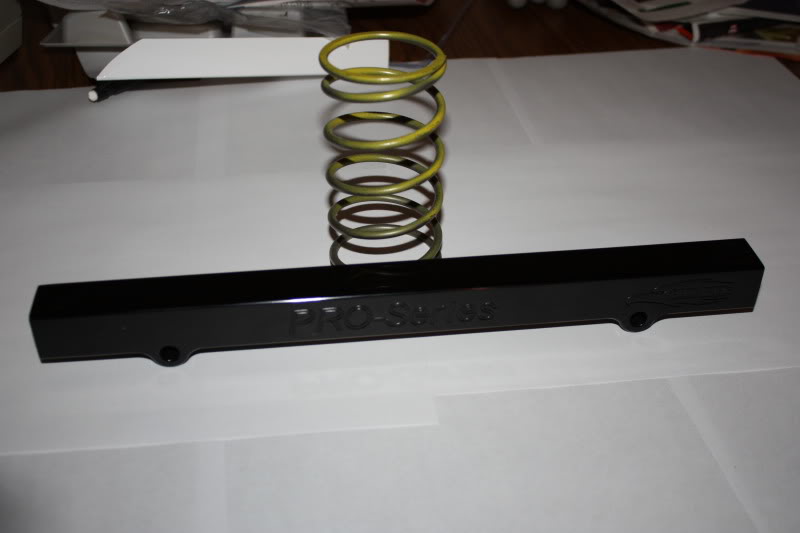

some new things for 010, the fuel rail im going to use and a nice 10lb spring

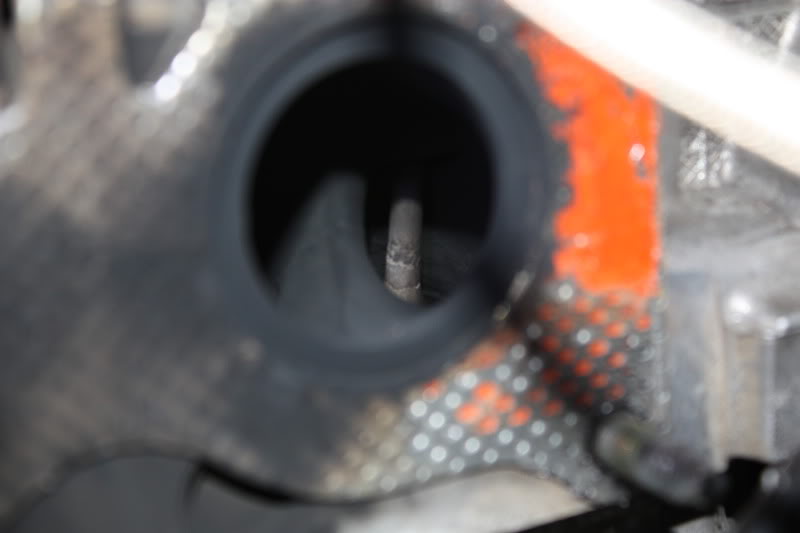

need to get my valves cleaned..

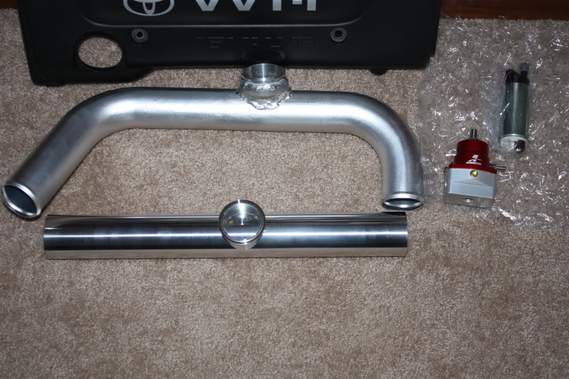

Pipe that im going to weld in in place of the straight section on my intercooler pipe to get rid of the old flange. Along with the fuel pump Walbro 255lph

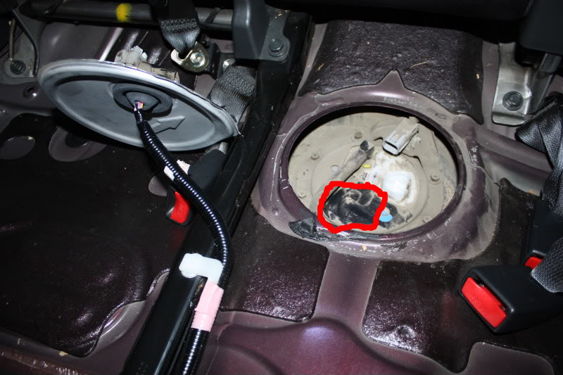

Looked at where I could put my return, I think im just going to cut the metal support plate here and then throw the bulkhead in the plastic for the fuel pump.. if the holder has a open spot there.

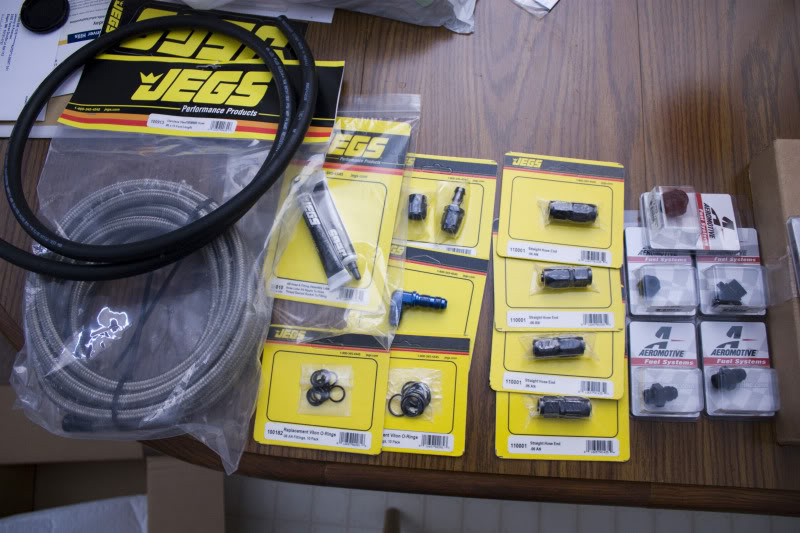

A few more goodies... not impressed with jegs.. I was missing 2 of the items I ordered and the gauge came broken.. :/

Picked up and made a few things over the past few weeks, and jegs was quick to send me a brand new gauge, thumbs up to them.

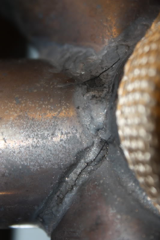

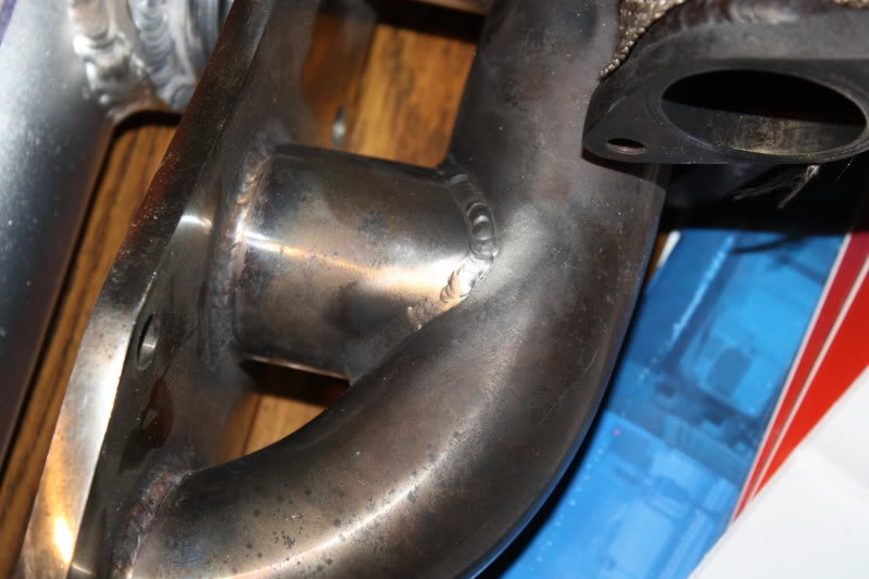

Exhaust manifold had them lay some pretty thick welds to hopefully hold it together for another year.

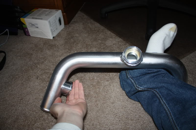

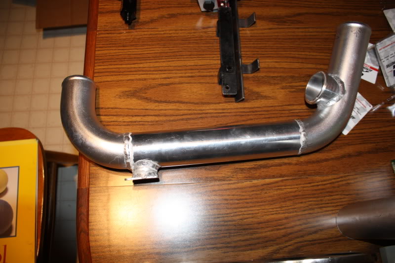

My hot side pipe right before the TB, much better way to do the BOV flange instead of just sink it in. Decided to just cut out that chunk and weld a new straight section in to cut down turbulence before the maf. Looks pretty promising
old way, sunk in
new way, flush

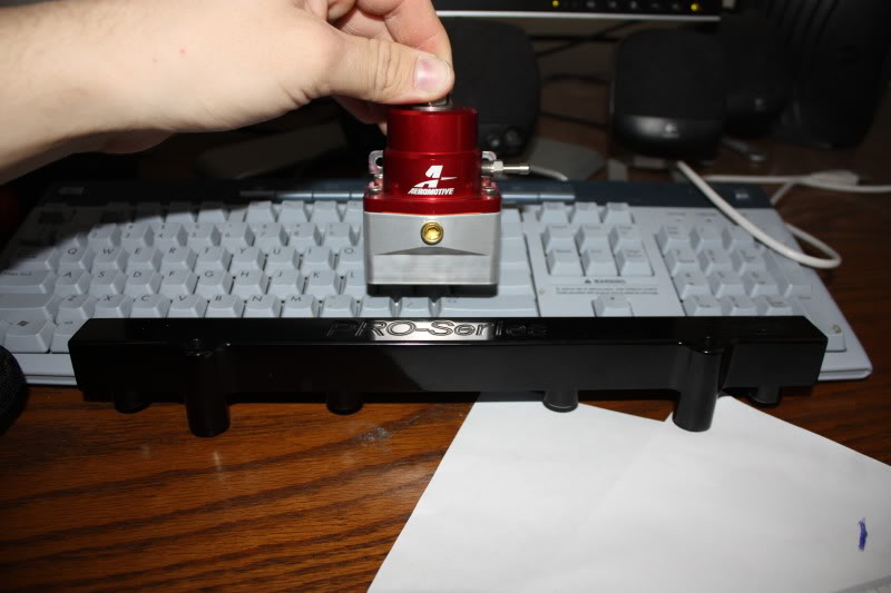

Made a new bracket to extend it enough to fit the fuel regulator on it along with my vacuum block and boost sensor.

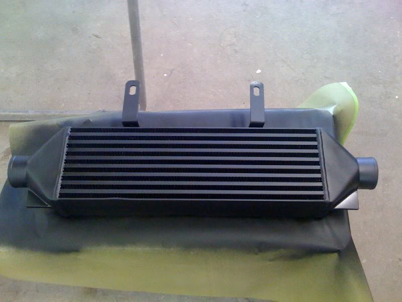

Painted the charge pipe and intercooler! I think its going to look sick!

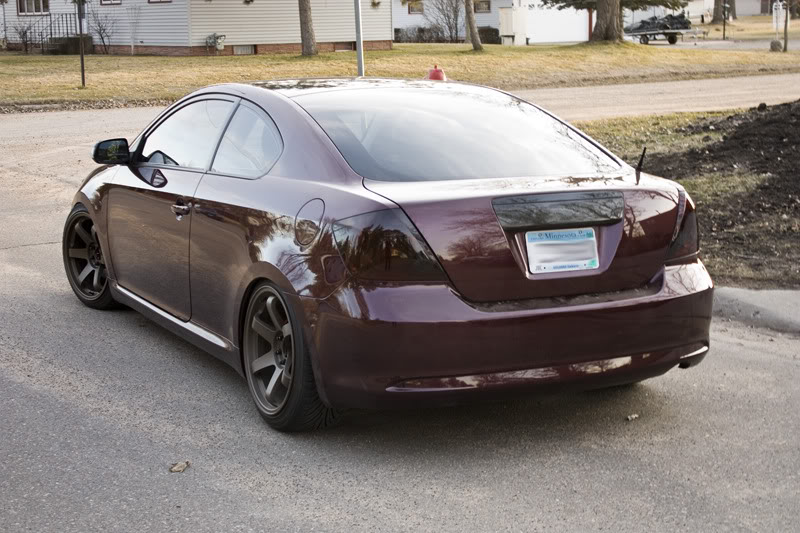

Started putting it back together again, after looking at the engine bay I think I am going to paint my valve cover the same color as the charge pipe..

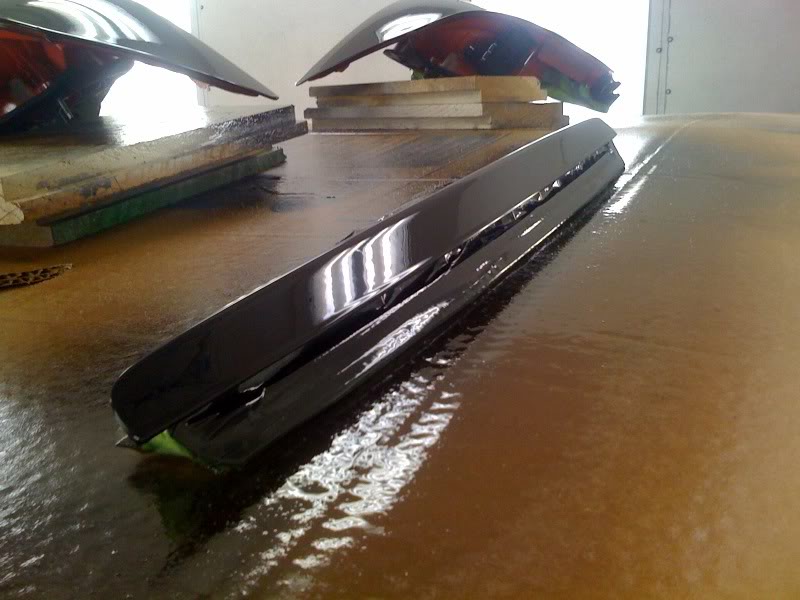

Got in a few new things, coilovers a second set of tails and 3rd brake light to vht, and a scangauge

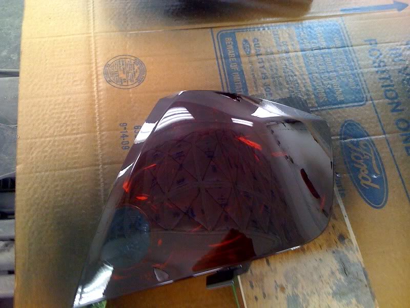

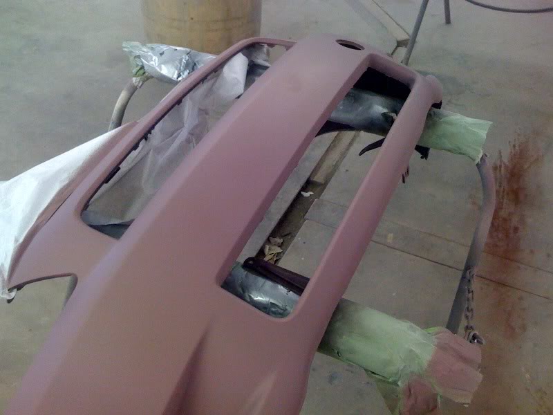

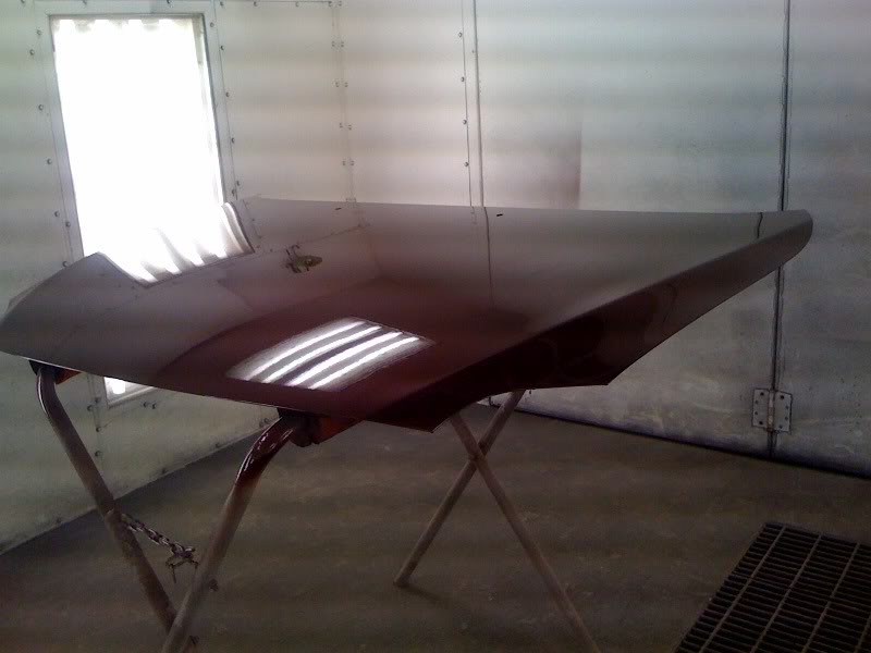

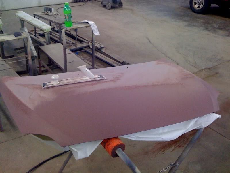

I was able to get the hood and bumper painted and my tail lights tinted this busy weekend... 2 coats of vht on the tails and 3 on the 3rd brake light. not bad for not touching a spray gun or doing any body work for 2 years.. like riding a bike. Filled in the front plate holes fixed a small dent in the hood and got rid of all those damn rockchips.

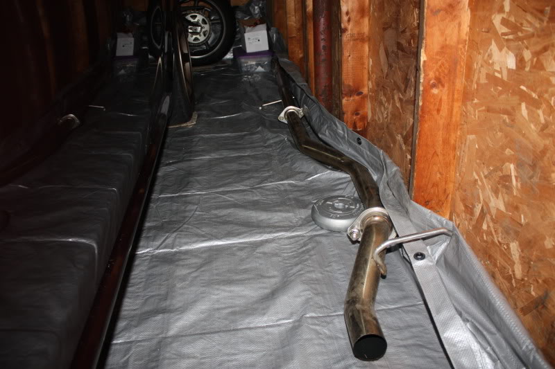

New 3'' exhaust from elite autosport, a cute little loud as ____ mid-dump
crude in the making pics of the exhaust

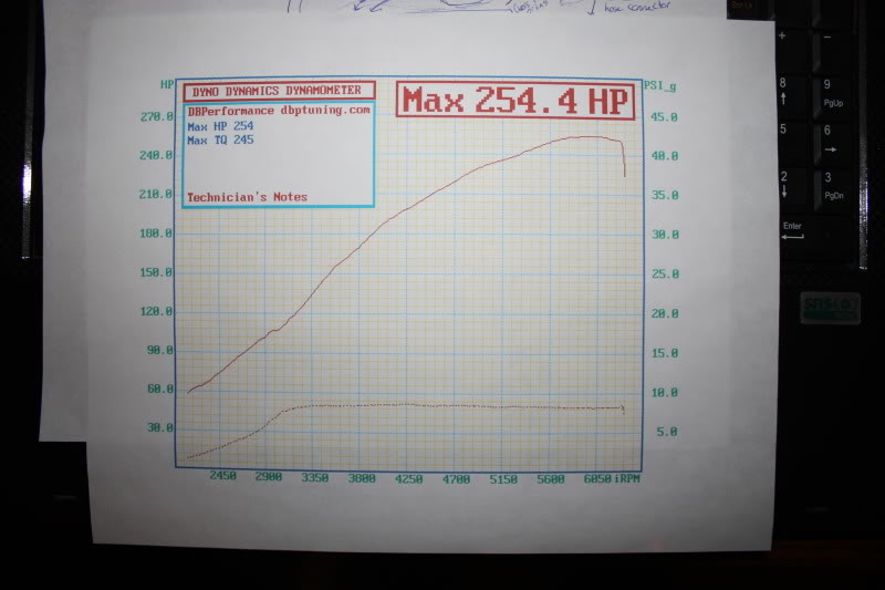

Got it re-tuned with the new setup and moar boost.. for some reason I was running out of fuel.. problem yet to be figured out but I am in the process of getting to the bottom of it.

ohh and do i see a custom manifold in the making??...(last pic of the exhaust to the right...lol)
