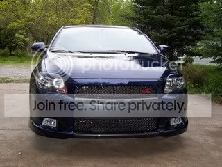

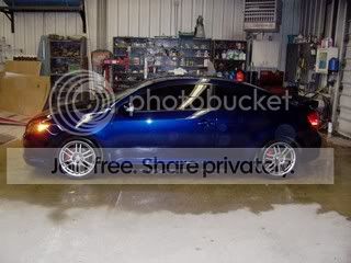

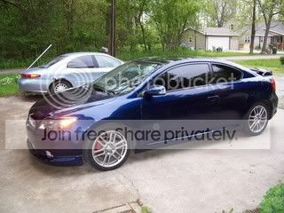

Ok finally got the camera to load a few pics.

optional's Avatar
Posts: 3,410
From: Bellevue, WA
needs bigger pics :D
