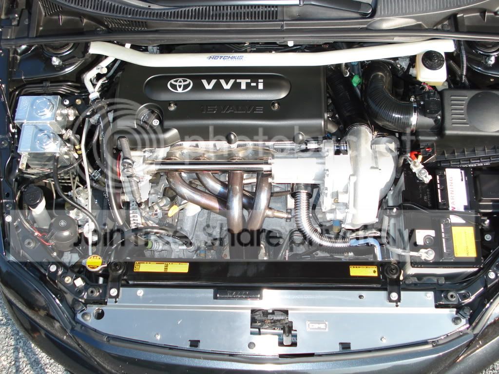

the pin hole was fixed and it was polished up nice. So I would have to bleed the system? What about the pressure build up? I made the cap able to relieve pressure without leaking fluid, but still had a mess because you have to keep it pretty full in order to keep air getting in the line from turning hard left...away from the hoses
Old May 7, 2009 | 08:39 PM
jamie1tc's Avatar
Posts: 226
From: Hampton Bays, New York
[img][/img]
Old May 7, 2009 | 09:03 PM
Ace83's Avatar
Ronin Scion
Posts: 11,117
From: TX
looks nice, i might be changing my water and power steering tank soon

hey jamie I just had to say that is a damn clean engine bay! Let us know how it goes! I might just have to pick this up meeself
