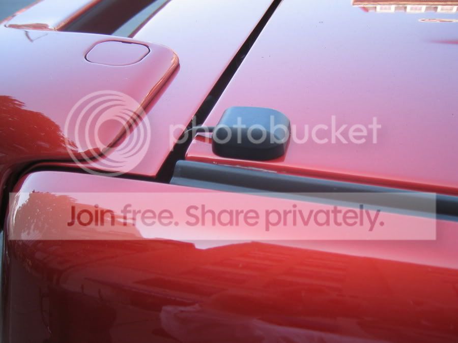

you can get what's known as a universal "plug and play" unit.. and these exist for both XM radio and Sirius Satellite Radio.. it's your preference to get sirius or XM.. usually in the package it comes with the unit, a docking station (i'd put mine out of the eyes of theives in the armrest) a cigarette lighter power adapter, an antenna, and an Fm modulator that broadcasts the signal over to the radio.. some have a couple frequencies to choose from like 88.1, 88.3, 88.5 FM others have more.. you get the idea.. just tune your radio to that station, turn on the main sirius or XM unit and you have your satellite radio.. the great thing about leaving the main unit in the armrest is there is a power socket in there, plus theives can't see it.. and the antenna can be mounted outside by the regular antenna, the wire run inside the hatch, around the rear seat cushions.. and up to the arm rest.. very clean install..
