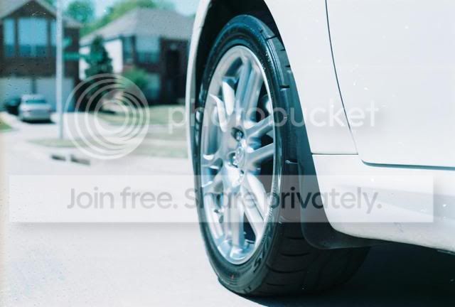

Running an extra set of OEM wheels with Azenis on them this year for autox. Tires mounted and ready to pick up tomorrow :D I would like some lighter wheels at some point too.. but I got the extra oems for dirt cheap, so I picked them up.

Got my fresh azenis mounted up and ready to go!!
