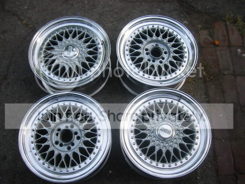

filling and re-drilling a great inexpensive option ($40-70 per wheel), but works best if your wheels have a centercap.
filled and redrilled
redrilled only
