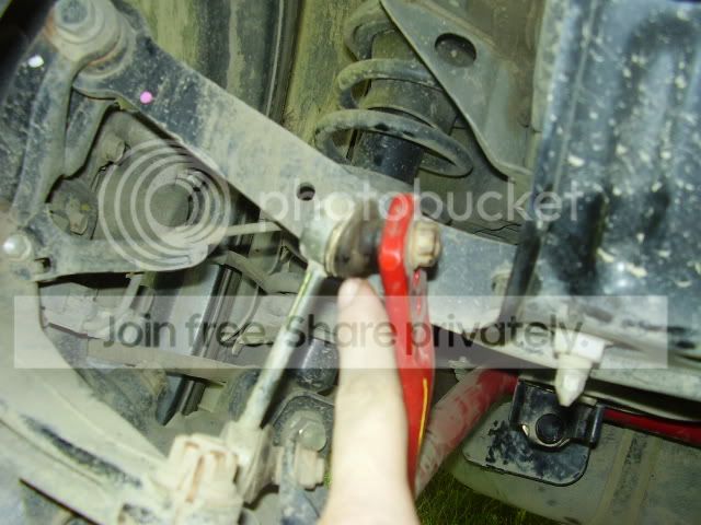

the play is in the drivers side endlink. i know its dirty thats what u get for livin in a rural area
i dont think the brackets would have anything to do w/ it. does the angle the link is at look right cause it looks like it has alot of stress on it. the car still has all stock supension parts if you guys are wondering. i am gonna pull a link off to make sure that is where the play is cause i ws going by watching it while someone pushes up and down on the car.

just ran downstairs to look at mine, hard to tell if yours is broken in any way or not. i will say it does look kinda funky but mine looks very similar.

it was a stupidity prob sorry to waste everyones time the top was a little bit loose after tighting it the noise stoped but when cycling the supension it still looks like there is play in it but i guess im just being paranoid.
