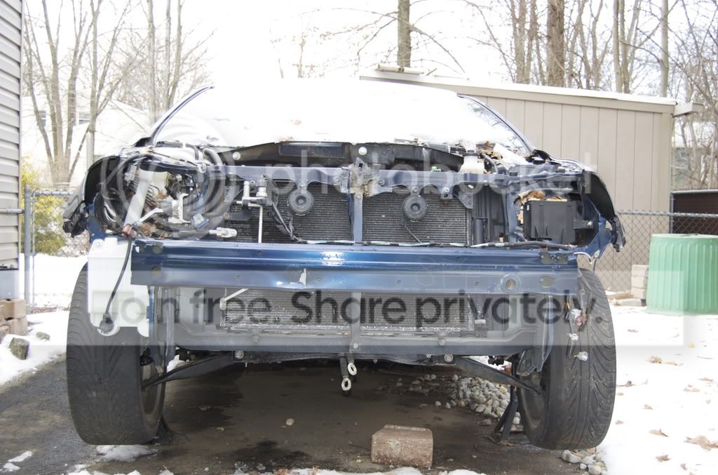

And again, contrary to what everyone says... camber is NOT the main destroyer of tires. Toe will kill tires a LOT faster than a bit of negative camber. You can easily run -2 or -3 deg of camber without any issues. But a bit of toe will shred some tires.

I beg to differ.

Man... the snow did a number on those tires.

handsoff: yep, from T-bomb. you know him? no alignment...didn't need to for awhile but i noticed how bad it was a year later when i took the wheels off to put on the new wheels. a lot of wear on the inside part of the tires in the front.
carbon: that's what my stock tires looked like too. are those stock wheels or what? what drop?

Those were Cooper Zeon 2XS tires and I was dropped on S-techs.
