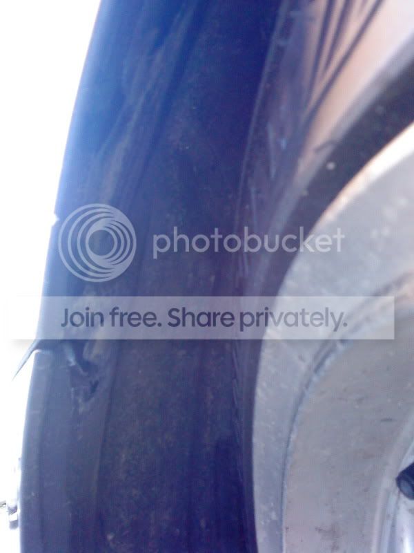

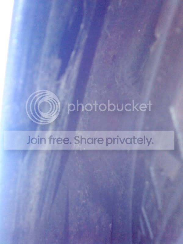

here is where my front wheels rub when i hit dips/bumps....i want to get rid of this rubbing..its killing me...so what should i do based on the area of rubbage....negative camber (with camber bolts) or roll the fenders? the worst rubbage occurs right at the portion where the front bumper meets the fender... there is a metal tab behind the plastic that's eating the ____ outta my tires.... help! (tire turned inward to show area.... sorry for crappy pics..cell phone...ill update ltomo morning with clearer digi pics...)
wheels: 18x8 et35 with 225/40 goodyear eagle gt tires
Suspension: Tokico blue struts with tanabe df210 springs
alignment set to factory spec, last i had it aligned 5 months ago.

Some negative camber will definitely help.
Also, try grinding the edges of that tab and bolt, it helped me.

i just took the screw out completely.

i was rubbing pretty bad in back and it was eating up my new tires.. so i rolled my fenders and all is well now haha

I dunno about unbolting the bolt...i dotn want the liner to drop off! all the other tabs have basically popped out!
update:
drove to south jersey yesterday..tore some tire up front AND back (damn bolt... ate a chunk) ...grr...tired of this rubbing...so finally dropped it off at the mechanic for some camber adj/alignment, and also the install of the H&R sway heh....ill update tomorrow with pics!! im hoping at least -1-1.5 front and back

call the mech, he said my rear was already 2.5 ish and he will adj to 2.9 (he was gonna change it to 3.5..ouch), fronts were 0.9 and he will adj to 1.3-1.5...opinions anyone??? Its a DD and i hope its not too aggressive....

front was adj to -1.5 rear -2.9....still rub on bumps...i guess i gotta get new springs or coilover kit......h&r sway bar...amazing!
