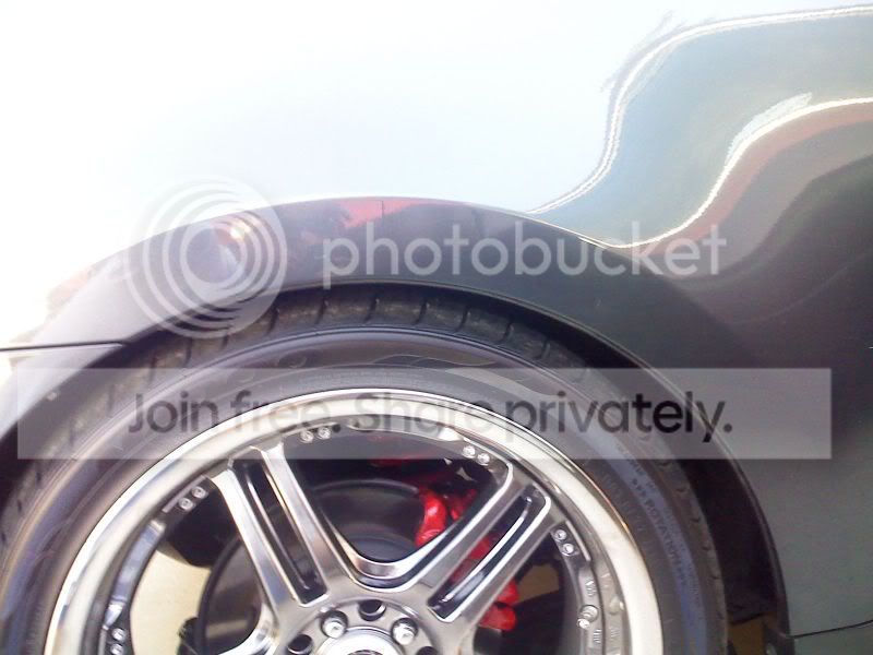

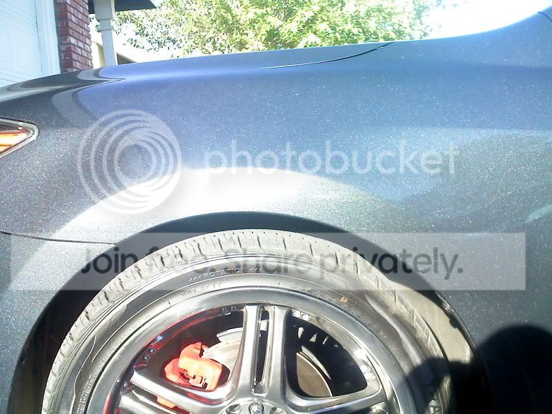

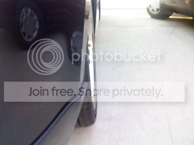

yes, the springs were purchased brand new from TRD blowout thread from Longo Toyota. the install was done by andino and another scionlife member who do so cal installs. here are some pics to show you guys what im talking about.
heres the car 5 days after the springs were installed:
this is the front with fingers in wheel well:
now, this is the rear with the finger:
and this is the negative camber i have in the rear only:
sorry for the cell phone pics. i dont have a digi cam...

The rear appears lower if you go by fender gap because of the way the fenders are cut out. The drop is right for the cars handling. Could be a tad lower, but more than 1.4" is too much handling wise, and mine settled to about 1.3 I think from stock.
There is no way they cant get it aligned right if they know what they are doing.
And I would leave some camber. I run -2 in back and -1.75 in front for handling purposes. The tires will be fine that way as long as toe is set somewhat normally.

so my left rear wheel is at -2.1 and my right rear wheel is at -1.7. the toe is preety much dead on. its just off by a a 10th of a degree. now my question is, if i get the camber fixed with the control arms that i need, will it raise the car in the rear? since the wheels are sagged inward the car is sitting lower. with the wheels straight will it lift the car a bit?

The control arms are a very expensive solution, and will likely make very little difference.
Adjusting your camber within typical limits does not affect ride height to a visually detectable degree. If you take it to the extreme, 15 degrees of negative or positive camber might net you a millimeter or two of additional height. I'd have to make the triangles to be sure.
To be honest, my mechanic was able to get identical camber on both sides. Such a disparity wouldn't usually be allowed out of the shop, unless the customer specified it in writing. It sounds more like a lazy mechanic than a technical issue.
