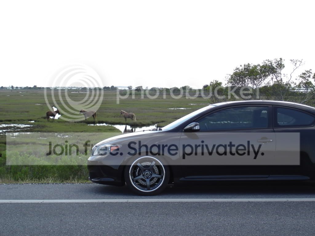

Old Jan 15, 2008 | 12:53 AM
greddy05tc's Avatar
Posts: 209
when i had mine dumped all the way down with a set of 225/45/18's thefront and rear were both tucking tread.
Old Jan 15, 2008 | 12:57 AM
05FMtC's Avatar
Posts: 1,243
From: San Jose, CA
Originally Posted by greddy05tc
when i had mine dumped all the way down with a set of 224/45/18's thefront and rear were both tucking tread.
yes i believe that b/c 225/45 = taller then a 225/40. so ya a 45 will tuck. right now the fender is right at the tire so with a 45 i can tuck but im lookin to keep the 40 profile. however, u got ne pics of ur car with 45's ?
Old Jan 15, 2008 | 02:24 AM
greddy05tc's Avatar
Posts: 209
Old Jan 15, 2008 | 02:29 AM
davedavetC's Avatar
Posts: 20,410
thats sick
