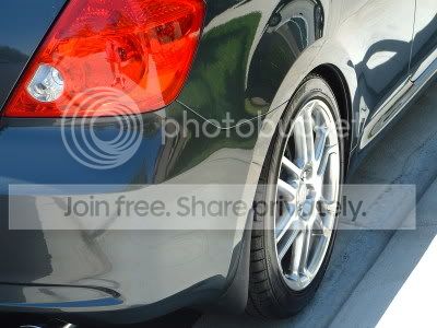

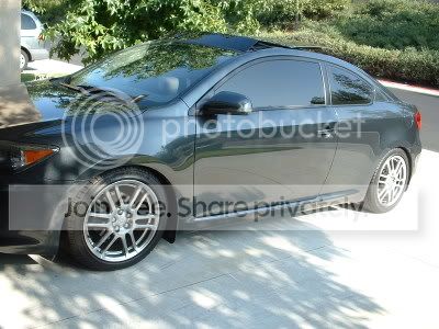

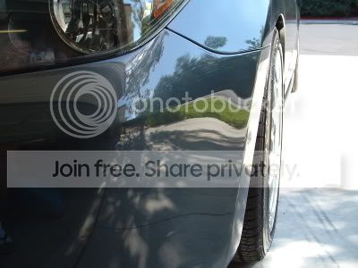

I wasn't happy with stock tires and rims tucked inside the wheel well so I installed H&R wheels spacers. The wheels are almost flush to edge of the wheel wells and hasn't rubbed yet. This is dropped with Tein S-techs so I think I'll bottom out first before the wheels rub to the wheel wells.
Front
Rear
Front & Rear

Old May 18, 2005 | 06:18 AM
bodjie's Avatar
Posts: 150
Which H&R spacers did you put on? Any zoomed out pics of the car?
I installed 20mm on front and rear, part# 4025541 and I paid close to $120-tax & shipping already included.
I'll try to get more pictures this weekend after I get my alignment and after I wash the car.
do wheel spacers bring the wheels outward a little bit?
Yes it does bring it outward, depending on the thickness of spacers you installed. In my case, I used 20mm so it pushed the wheels out 20mm. I probably could have used 25mm for the rear but the lip of the wheel well is L-shaped so it might rub.
BTW, I have some DIY with pictures when I did the front. It's posted at clubscion in the DIY section if anyone is interested.

looks good. any more pics from a farther perspective but at an angle where we can see the wheels flushed to the fender?
i was comptemplating this and powdercoated wheels so that i dont have to get aftermarket wheels.

I would love to see some more pics from different angles also. The rear does look like it needs to be kicked out just a few more mm's to be flush with the fenders. Maybe a 25mm spacer would work for the rear? Either that or a 15mm front/20mm rear spacer so it looks more balanced.
Would it be safe to have a 20mm front /25mm rear spacers on? Or do they only come in sets of 4's? I have TRD springs I wonder if this would work.

My question is how much of a drop do you get on S-techs. I am wondering if I could get 25mm on the back since I only have the TRD springs, which probably gives you the smallest drop out of all the kits out there.
You get about 2 1/2" front and about 2" rear on S-techs. The 25mm would definitely look better on the rear since the outermost edge of the tires will be flush with the edge of the fender. My only worry is that since the inside lip of the fender is L-shaped, it might rub if I hit a bump.
You are definitely correct. A 5 mm difference would have been perfect.
I could not tell you if it's safe but I'm assuming it is since they are hubcentric. They do come in set of 2s so you can get a set of 25mm for the rear and a set of 20mm for the front.
Here are the prices from optauto and H&R part # 4025541(20mm) = $100 + tax +S/H
5025541(25mm) = $120 + tax + S/H
