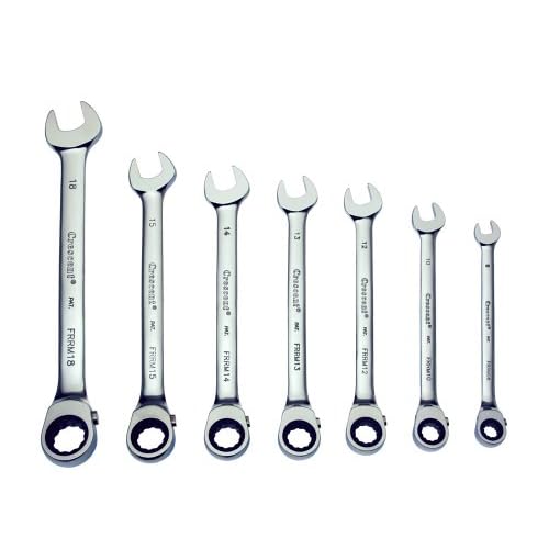

I posted in the other thread too, if you have a ratcheting open-ended wrench, it makes that last bolt a piece of cake
taking off the windshield cowl sure does make it easier though, and it only takes 10 minutes, if that.
just get it as hand-tight as you can with a standard open ended wrench, and if it doesn't solve the problem, bring it to the dealer and tell them you want to ride with a tech to SHOW them the problem.
Good Luck.[/img]
