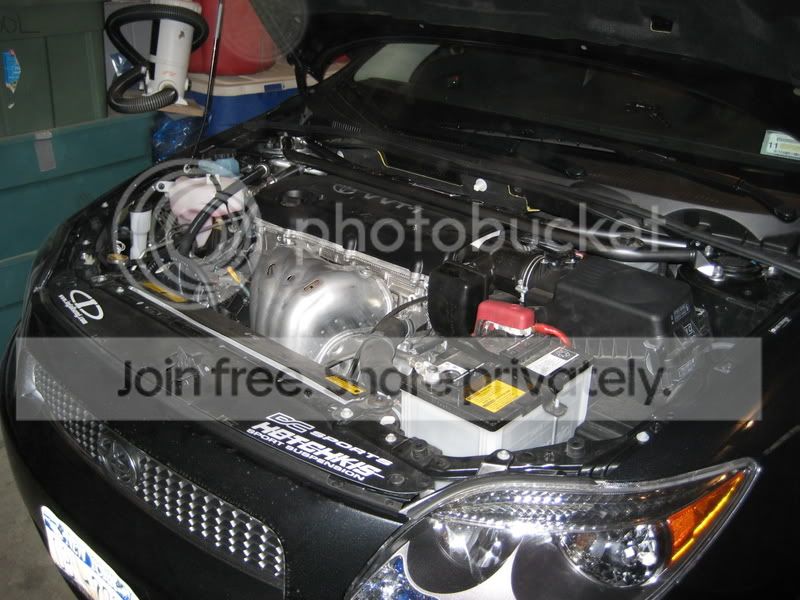

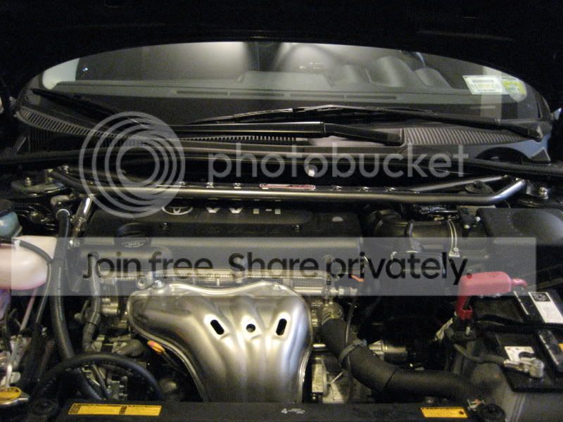

well i got the bar on with the ingalls, had no problems at all, the bolts wer plenty long. i used 2 washers on the other strut tower oposite the stiffy to level it out as well. heres some pics.
i don't know if the bar actually did much cause i also just installed springs and a rear sway just a week ago so idk. i just didn't have enough time to get used to the springs and sway to know if it did much. but it looks great and fits great.
almost forgot to mention i got it at Wesellcarparts.com . great customer service and great prices. order from them! now!

Yeah, i know my engine bay is filthy...meh.

wow that barely fits on there
Old Jan 15, 2007 | 02:05 AM
jjos1's Avatar
Posts: 2,605
I had rubbing on the hood lining with my stiffy/ tanabe bar when I had it. I also noticed that it seemed to amplifiy the vibrations from the stiffy.
