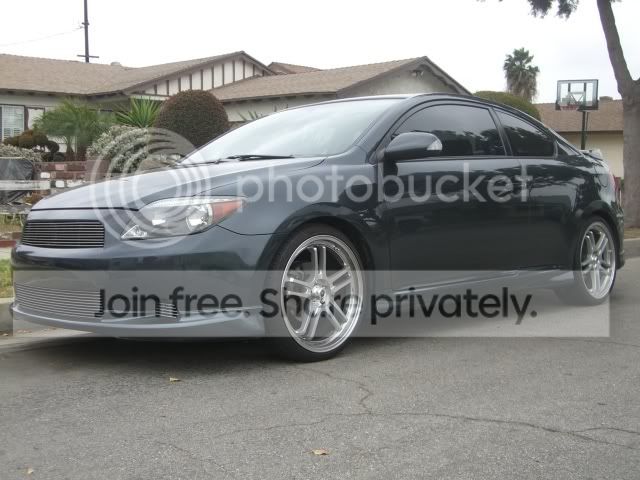

here's how my drop looks. i really wanna just close the wheel gap. i'm not sure if the h&r sport will drop enough to close it. i might end up getting the h-techs. what do u guys think?
Old Mar 20, 2007 | 11:29 PM
exige's Avatar
Posts: 1,694
the h&r sports are the optimal drop...anything more than 1.5" and handlight actually decreases, not increase.

Yea H&R will get rid of that gap....but if you want to get rid of more gap then H-Techs would be fine. Hotchkis imo will be very low and you might rub depending on your offset.
