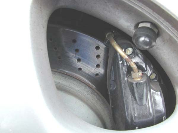

Stuttering when braking is caused by crossdrilling and slotting. Absolutely zero benefits, purely marketing. Put any smooth rotor on and braking will be... smooth! How about that! ;)
Removing material for holes and slots reduces thermal-mass of rotor. Meaning for same braking-force and heat generated, drilled & slotted rotors will heat up more! Genuine Porsche rotors with holes are not drilled. The holes are cast in place as part of manufacturing process. This preserves continuous grain-boundaries that drilling would not do. However, you still end up with variable heat-gradients and stress-risers around hole. So even Porsche's own "drilled" rotors will crack. Guess which model this was from?

FWIW, rotors are much less likely to crack due to being d/s if they do it properly and chamfer the holes and drill @ the correct time in the casting process.
Been on my d/s rotors 2 years so far and no issues. No issues on my previous car either, just don't cheap out on the parts.
