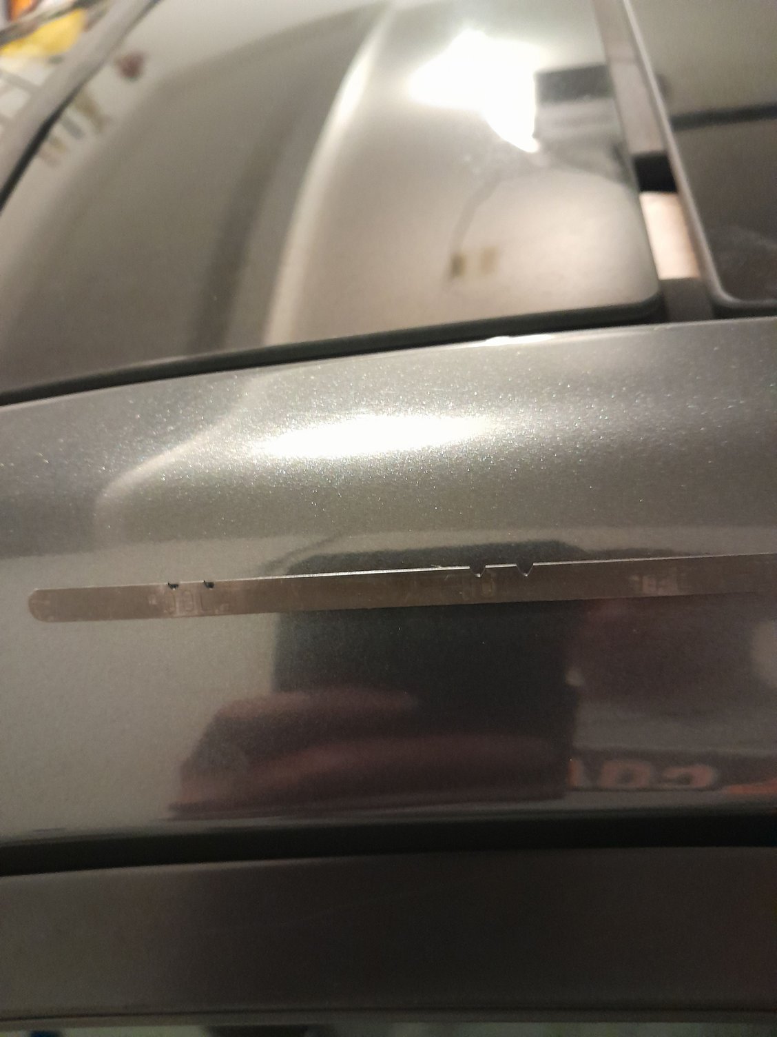

I have a picture of the dipstick lower 2 marks are cold, and upper 2 marks are hot. Do i fill it inbetween the 2 marks the best i can? Or go for the upper mark?

Personally, I'd go to full. I always figure the top dot exists for a reason and that's where it should be filled to, but anywhere in between is an acceptable range. Just try not to go over.
Hard to cycle thru the gears in an ATX without moving. I'd probably pour in the amount the book says, see where the level is, then drive around a bit to warm it up and then recheck and add accordingly (in my experience the book is generally a bit low).
